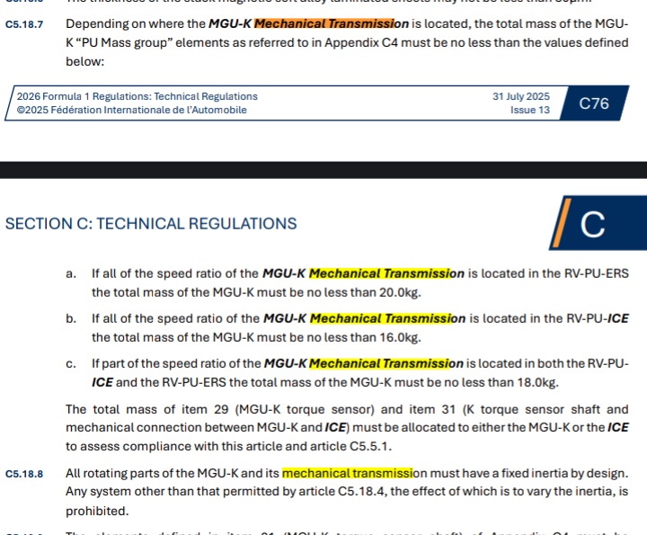

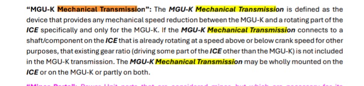

The MGU-K also has to be connected directly to the crankshaft, so it can’t use any gear reductions...

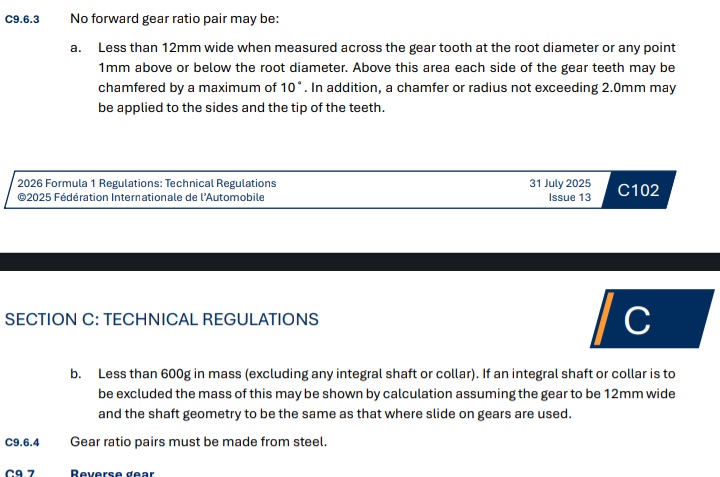

I wonder if there's a specific regulation regarding the size of those gear
