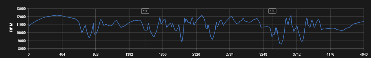

Not so sure about this logic because cars really aren't "lower down in the rev range" in the power limited parts of the track.Just_a_fan wrote: ↑24 Jun 2026, 17:21Any power you add lower down the rev range will bring a benefit - the cars don't go from idle straight to maximum revs, they build and any additional power added during that rising rev phase will absolutely accelerate the car harder. That allows more punch out of a corner, for example, and thus enables top speed to be reached sooner.venkyhere wrote: ↑23 Jun 2026, 02:10
Actually, compared to road cars to whom peak power (or power number around peak power RPM) isn't that important ; in F1 cars peak HP is a very reasonable measure of performance, vide the simple fact that the % duration of full throttle and % duration of near-peak RPM (in all gears) over a laptime duration, is a much much higher proportion.
The only time a car really goes below 10k rpm whilst on throttle is out of some of the slower corners, and on initial acceleration out of those corners you are far more traction limited than power limited, especially with 350 kW of MGU-K helping. By the time the car actually needs the full grunt from the ICE you are already back in the optimal rev range and pulling gears.
