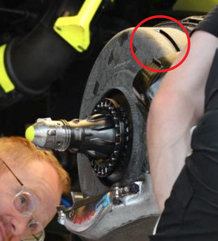

620
Re: Mercedes W17
DM: “The open wheel rim regulations are indeed an opportunity for the teams, perhaps not very visible on television for the general public, but highly significant. The design of the wheel rim has changed a lot compared to last year; we’ve seen rims with hollow spokes, which some teams call pockets, and this is precisely to facilitate heat exchange with the cooling of the brake ducts, so to speak. We actually see differences among the various teams in who manages to, I wouldn't say manage it better, but manage it differently. For one team, the goal might be to heat it up, while for another team, it's to cool it down, depending on the car's balance. So, we see differences, and it is a significant performance lever.
“They can effectively govern the pressure build-up, from the starting pressure to the stabilised running pressure, in an efficient way. Sometimes, when we look at performance and see a certain consistency in lap times, especially during a long run, it is also determined by how well the team manages to control the pressures, keeping them within the optimal window throughout the stint thanks to these devices."
https://www.motorsport.com/f1/news/f1-m ... /10838725/

Re: Mercedes W17
620
Re: Mercedes W17
This is from Mateusz Mróz. I cropped it to highlight this slot in the inner cake tin.

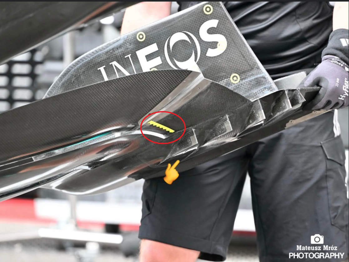

620
Re: Mercedes W17
I'm not sure what the word for it is, but it's interesting that they are using "transition tape" on the underside of the wing. The yellow picket fence. The purpose would be to transition the boundary layer on the underside of the wing from laminar to turbulent. You don't normally see this.
