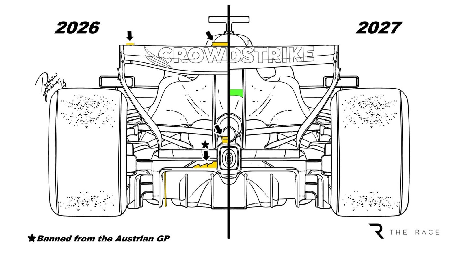

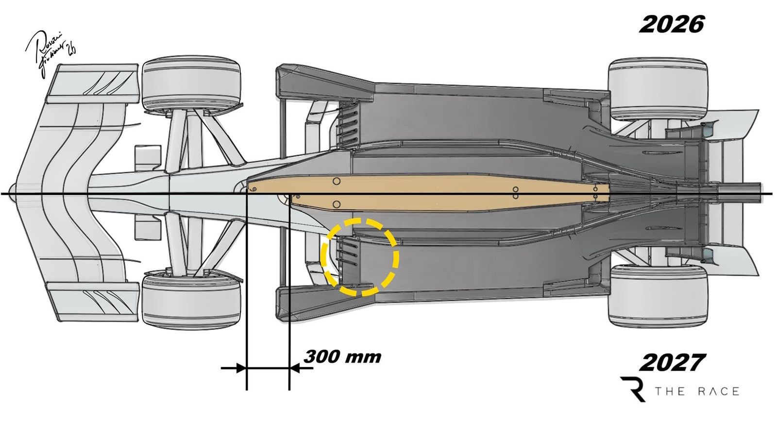

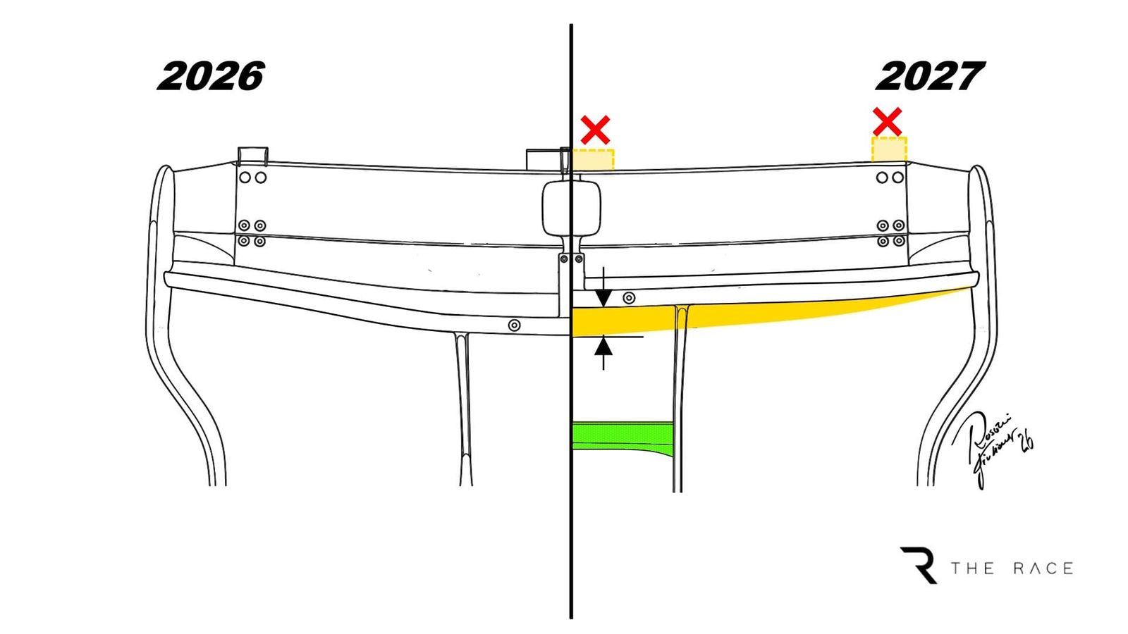

Some changes to the floor and rear wing regulations for 2027 incoming.
- James Vowles
621
Re: 2026 Aerodynamic & Chassis Regulations
FW17 wrote:
17 Jul 2026, 13:44
- James Vowles
These have already been leaked. Smaller bib. smaller rear wing box, ban on sticky uppy bits.

So they have made the RW smaller, hoping that it will reduce superclip duration and make the energy requirement lesser. But it does reduce downforce, and might end up penalizing the recharging under braking and through corners. In which case, what to make of it ? is it going to improve or worsen laptimes (w.r.t 2026) on a "typical" track, like Bahrain/Barcelona ?
what is that green element for 2027 ? cross-member reinforcement for the twin tower RW supports ?
