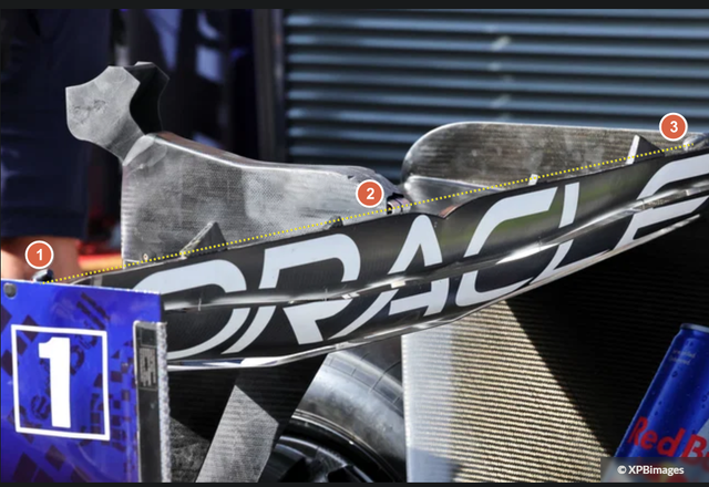

In the rear view you can see the pivot in the center. It's "virtual" in a sense, but the center actuator moves around it, and it's coincident with the outboard pivots. Mclaren's design is a bit different, which is why I think they may have retained the hinges from the non-macarena wing.

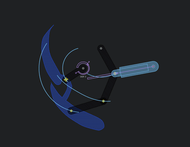

My best attempt at the macarena mechanism. There's a small collision at the end between the links that wouldn't happen in the real thing, of course.
