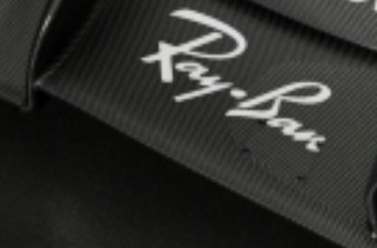

That is the "an" from the logo of the sunglass company Ray-Ban.
Ferrari has had Rayban logos on the car since 2016. It could be Ferrari, but might not be a Ferrari F1 car since most Rayban logos were on the larger body shell components like the engine cover over red areas. It appears that the number of the part aligns with Ferrari's catalogue prefix and parts code: 2026 Ferrari SF-26 (Project 678) within the 611678239E02-05-P0 so it could very well be ballast 239 at location5 parts version 0 of the 125g ballast. E02 is for Evoluzione and 05 is the placement, and p0 is the version.
Here are the F1 teams that had Rayban sponsorship previously.
Prost Grand Prix – 2001
Brawn GP – 2009
Mercedes GP – 2010–2011
Bar Honda – 2006–2008
Here you go.
Update: it looks like it's from the front wing right mainplane. You'll have to zoom in on the photo to see the 4 screw holes.

Thank you very much for the hint — it appears to be a real bullseye!
The number on the part seems to read:
611678239E02-05-P0
The sequence 678 matching Ferrari’s internal project code for the SF-26 is a very strong indication, especially since 239 also appears handwritten on the part.

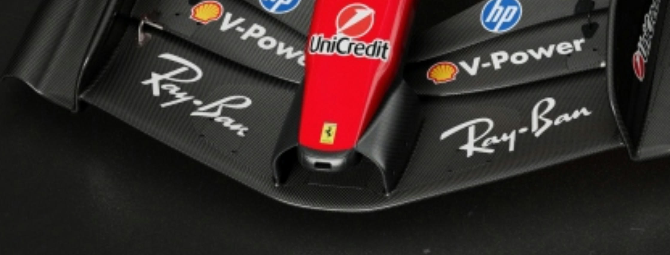

I'm fairly certain this is from the RIGHT hand side front wing mainplane. Not anywhere else on the chassis.
It is the only place the Rayban logo is on the car and it's orientation indicates with "an" that it is the front right wing mainplane. It does appear that the logo placement is shifted from this PR photo's ballast plate cover.
The left side has Ray on it:

the left side of the front wing in the direction of travel
