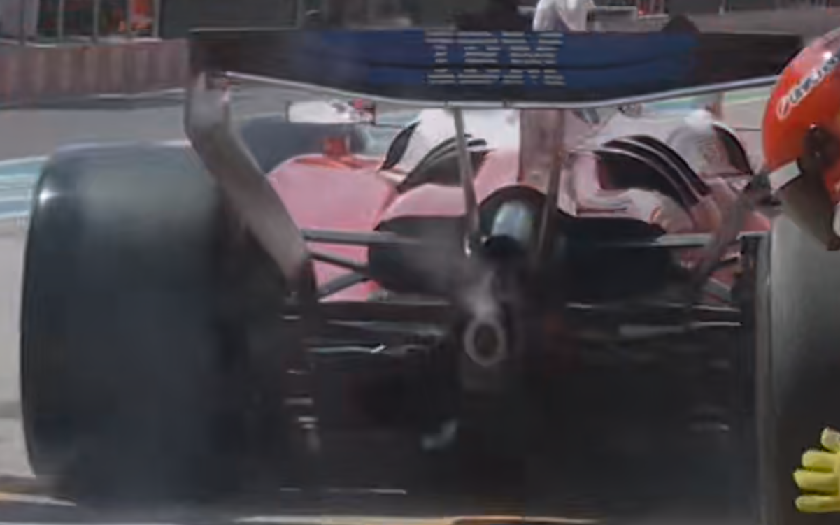

Re: Ferrari SF-26
It's another weekend where Ferrari has the back of the car cut open much more than any other team

https://i.postimg.cc/cHRCsVrD/image.png
Means the engine is very sensitive to higher temperatures. Likely not as great knock-characteristics as Mercedes. If the upcoming combustion upgrade really works, there should be an aero-benefit from less venting on top of the increased power.
