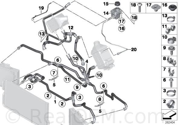

Here is an image of BMW M5 water to air system, notice the network of hoses and pump to control temperature:
There are two auxiliary water pumps (not shown) for the water-air intercoolers. I believe they are electronically controlled.
Maybe Mercedes could be doing this, who knows. If it's legal it's another issue. But as I said it's really weight, reliability, complexity and packaging and energy efficiency where this system loses out to an air-air.
Drivability, flexibility, and control are advantages, but again it all goes back to the magnitude of these effects.
