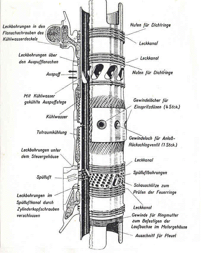

“The ideal combustion chamber is whatever offers the largest flame front area, fastest burn rate and minimal flame-wall contact. Heywood specifically states that a disc shaped chamber (rectangular cross section) where the flame initiates from the side is the worst in terms of combustion speed.”
According Heywood, the Junkers JUMO 205 (first run: 1930) with the “disk shaped chamber where the flame initiates from the side”:
should not run as it did / does:
The BSFC plot (bottom middle):
shows a 0.35lb/hp/hr (i.e. 216gr/kWh, which means a Brake Thermal Efficiency (BTE) of 37.5%).
(click http://www.pattakon.com/tempman/Junkers ... 5_BSFC.jpg if the drawing is not clear).
The peak injection pressure is only 600 bar.
The design is old (more than 80 year old).
The 37.5% BTE is maintained in a wide range of revs (from 1,500 to 2,500).
The 37.5% is not the peak BTE of the engine.
The fuel efficient, lightweight and reliable Junkers Jumo Diesels enabled, for the first time, airplanes to travel at distances not possible before.
So,
either Heywood is not right, or the rest characteristics of the Opposed Piston Jumo 205 are by far superior than those of the state-of-the-art modern Diesels (wherein the flame initiates centrally, wherein the fuel is injected at way higher pressures (fine droplets) and with the perfect timing, wherein everything is optimized by computers, etc, etc) to justify the 37.5% “working” BTE .
Now, take the Junkers Jumo 205 and modify it to PatOP or to OPRE.
Use either the centrifugal compressor of the Junkers Jumo 205 as scavenging pump, or, preferably, a turbocharger driven by the exhaust gas.
The lube specific consumption drops a few times and the frictional losses reduce (cross-head architecture, true hydrodynamic lubrication whereon the thrust loads are taken and the torque is created.

A pulling connecting rod is way stronger for the loads it bears (so it can substantially more lightweight) than a conventional connecting rod. The heavy loads in the OPRE / PatOP try to strengthen the connecting rods.
The engine gets shorter and more lightweight:
The PatOP prototype (64+64=128mm stroke, 79.5mm bore, 636cc capacity, 850cc built-in scavenging pump capacity, total mass (without the flywheel) 20kg, total height: 500mm)
Etc.

What I see in the above youtube video is a redesigned Junkers Jumo 205 with reasonable / expected improvements:
better flow capacity,
optimized combustion chamber shape,
modern fuel injection,
better/modern control over the engine (electronic control versus mechanical control).
It is like giving to a good tuner an 85year old Junkers Jumo 205 and ask him to improve / modernize / redesign it from scratch (and in a “no budget” basis).
Different tuners will follow different ways / solutions.

“Anyway, back to piston rings: One of the big disadvantages of liner ports is the high amplitude high order distortion of the bore. The shape filling capacity of the ring is inversely proportional with the 4th power of the order of distortion. In a conventional engine, the dominant distortion order is more or less the number of head bolts and its amplitude is quite low. In a liner full of 'holes' the order will be much higher and the amplitudes larger - that is to say they will be rubbish at sealing. I am trying to keep this post reasonably short - if you want any further details on the physics/ maths I will be more than happy to share.”
Here is a “full of holes” liner of the Junkers Jumo 205:
And it is anything but “rubbish at sealing”.
This is a more than 80 years old design / manufacturing.
17:1 compression ratio, compression ignition.
If it had problematic sealing, or not top fuel efficiency, it would not be used in airplanes making (for the first time; 1936) 6,000 miles without a stop.
Your theory relating the “sealing efficiency” with the number of holes / ports on the cylinder liner needs amendments.
For instance, a cylinder liner having a wide exhaust port at one side, and a number of transfer ports around the cylinder has many reasons to deform and spoil the sealing.
Also a cylinder liner whereon the piston skirt thrusts heavily, or a cylinder tighten to a cylinder head by bolts, have good reasons to deform and spoil the sealing and the lubrication:
The thrust of the piston skirt on specific regions at the sides of the cylinder liner spoils the shape of the cylinder liner and makes the temperature distribution around the cylinder liner uneven (this unevenness is further increased by the non uniform arrangement of the intake and exhaust valves on the cylinder head).
A cylinder head integral with the cylinder is a good solution (Bishop rotary valve F1 engine uses this method, and besides avoiding the gasket and improving the cooling, it also reduces the overall weight of the engine).
Another good solution is the approach of Hugo Junkers with his twin crankshaft Opposed Piston Jumo engines wherein the intake ports, at the one end of the cylinder liner, and the exhaust ports, at the other end of the cylinder, are too many and uniformly distributed. Only the thrust loads on the sides of the cylinder liner spoil the – otherwise perfect – cylindrical symmetry of load distribution, temperature distribution, etc.
A far better solution is the OPRE and PatOP “cross head” architecture where the cylinder liner is, among others, completely rid of thrust loads.
The cylindrical symmetry of loads and of temperatures gets perfect.
The high gas pressure during compression – combustion – expansion is the only load the cylinder liner bears (the thrust loads are taken by the cross-head, away from the cylinder liner).
Can you think a more symmetrical load for a thin walled cylinder?
The temperature varies along the axis of the cylinder liner (hotter at the exhaust side, colder at the intake side), however the temperature around any “cut” of the cylinder liner normal to the cylinder axis is constant.
All the previous are ideal for the cooperation of the piston rings with the cylinder liner (improved sealing).
So, think again.
