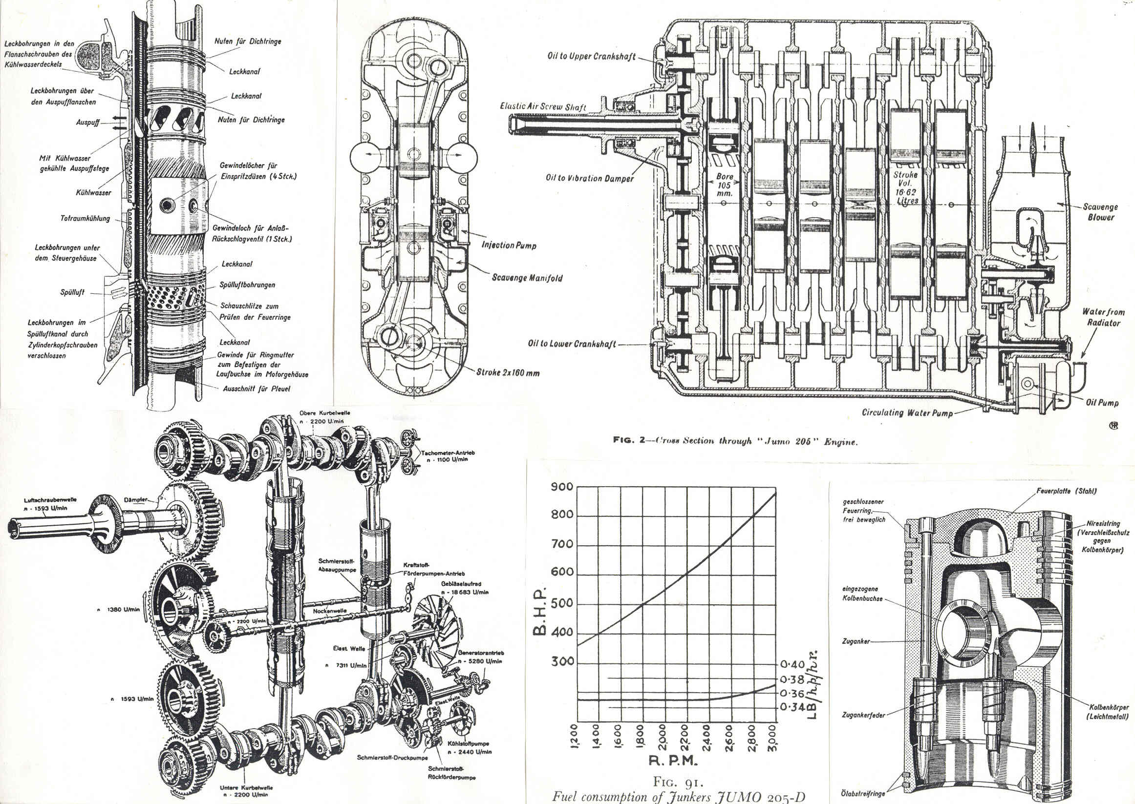

FEV says the inspiration for the OPOC design comes from both the Junkers Jumo twin-crankshaft diesel aircraft engine and the opposed-cylinder (“boxer”) design of Ferdinand Porsche.

The Junkers Jumo 205:
has six cylinders and twelve pistons.
As shown at bottom-left, the crankpins of each crankshaft are equally distributed per 60 degrees; they shown at 0, 120, 240, 180, 300 and 60 degrees.
With the balance.exe program at http://www.pattakon.com/pattakonEduc.htm the free inertia torque is calculated at zero.
So, from this point of view, the arrangement seems perfect.
However, when the phase difference between the two crankshafts is wide, there are “torsional issues”.
The larger the phase difference, the worse the torsional issues.
How?
The total combustion torque in an Opposed Piston like the above Junkers Jumo, is the sum of the combustion torque acting separately on each one of its two synchronized crankshafts.
When the two opposed pistons of a cylinder are at their closest to-each-other position (i.e. when the combustion chamber volume gets minimum) the crankpin driving (through a connecting rod) the one piston is substantially before its respective “TDC” (which causes a heavy “negative” torque on its crankshaft), while the crankpin driving the other piston of the cylinder is substantially after its respective “TDC” (which causes a heavy “positive” torque on its crankshaft).
The instant total torgue (due to the combustion pressure) provided by the cylinder is the sum of the above two torques.
Increasing more and more the phase difference between the two crankshafts, the peak instant torque acting on each crankshaft separately, gets substantially bigger than the peak instant total torque provided by the engine.
This way the crankshafts (and the synchronizing gear between them) are overstressed (torsional issues).
