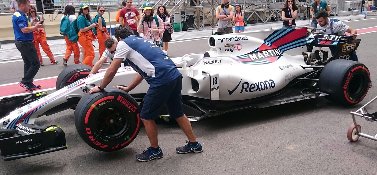

Re: Williams FW40 Mercedes
Hmm. I wonder if the photos are consistent with my vortex sweep hypothesis? haha. Those two new vertical vanes seem to create two vortices that interact closely. One is in front of the barge board the other behind...
Interesting that they have a low downforce front wing, but the rear wing looks the same to me.
