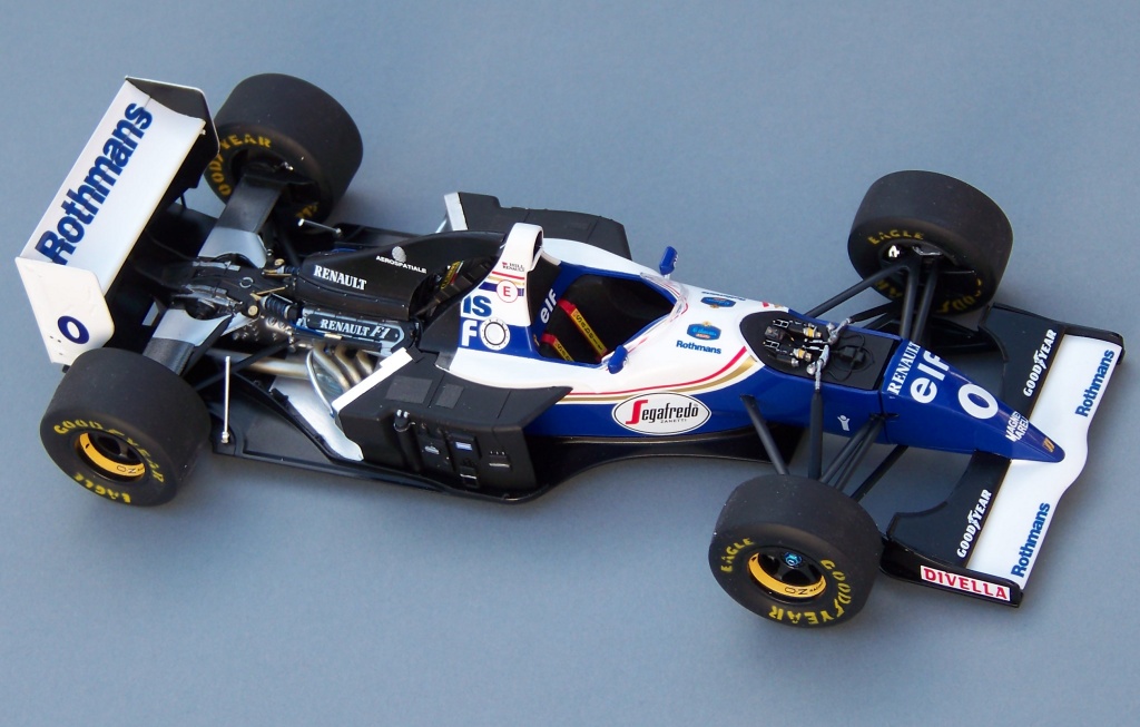

I had a similar thought in 2014/2015 :mrgreen: Remember the Williams FW-16...
http://www.gurneyflap.com/Resources/FW16-1413.jpg
http://www.marcosaupe.de/images/mod_FW16_07.JPG
