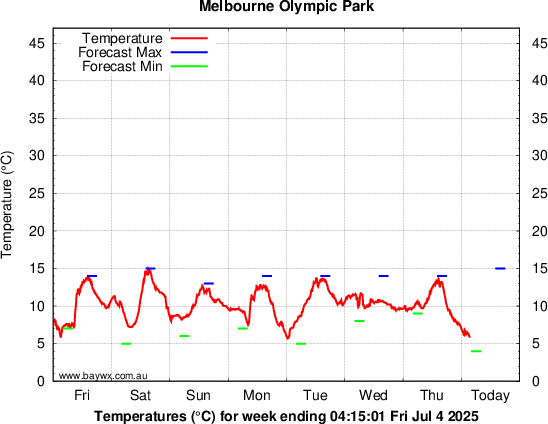

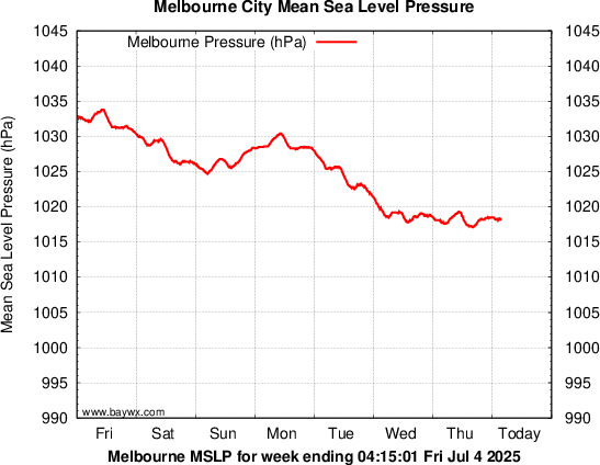

here's a graph of atmospheric pressure in melbourne for the last week
and here's the temperature
hard to pick a 24 hour cycle in the pressure.

Having said that there might be a bit of a peak at mid day, but nothing like 10/300*1000 =30 millibar

Greg's data shows a trend of pressure and temperature rise and fall together over days - and London data has the same pattern
broadly temperature and pressure rise and fall together and so air density changes little in the long term
