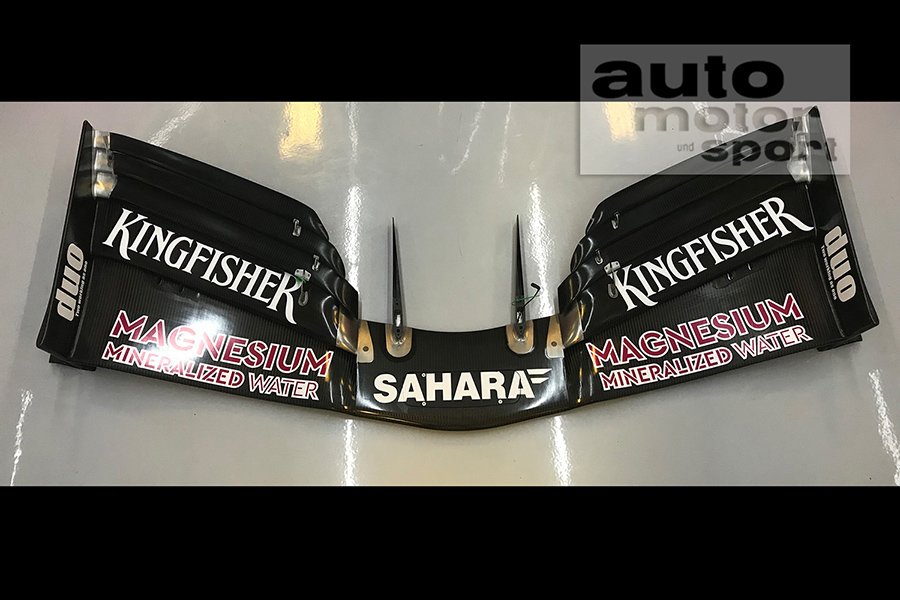

Force India 2019 prototype FW.
via AMuS

Is it just me who's excited about the new front wing? It has no outwash tunnels. That's a big deal! No one has come up with such an innovative idea for a FW since maybe 2009. Good job by Mclaren aero dept. The car as a whole might be slow but it's littered with clever ideas.
What is the benefit of this type of wing?
Maybe 2019-ready concept?
FI 2019 FW.
Very "plain / simple looking"

I'll eat my hat if the FW's actually end up looking like that. Outer tunnels will still work for lofting airflow over the tyre.

MtthsMlw wrote:
30 Jul 2018, 12:37
It's worth pointing out even Force India won't be playing their full hand here. Interesting though - wonder how much is FIA spec and how much is their interpretation.

jjn9128 wrote:
30 Jul 2018, 13:06
They plan to run this FW in the post Hungary GP test. I guess this says a lot.
I'm not sure how specific the rules are regarding the ''tunnel'' we see on todays FW.

The teams will still get them to do what they want.
Have we seen the actual rule book on these yet? Holes in the endplates where the upper elements can poke through would still create outwash, and unless the upper elements are given a flatness specification, they will still loft as PhillipM states.

MtthsMlw wrote:
30 Jul 2018, 13:15
jjn9128 wrote:
30 Jul 2018, 13:06
We'll see - FIA haven't published online yet - I'm not even sure teams have the definitive wording. From what I understand the wing's have to join the endplate on the horizontal, i.e. perpendicular to the vertical endfence, but whether than allows them to make a cone/tunnel inside the endfence... I dunno...
