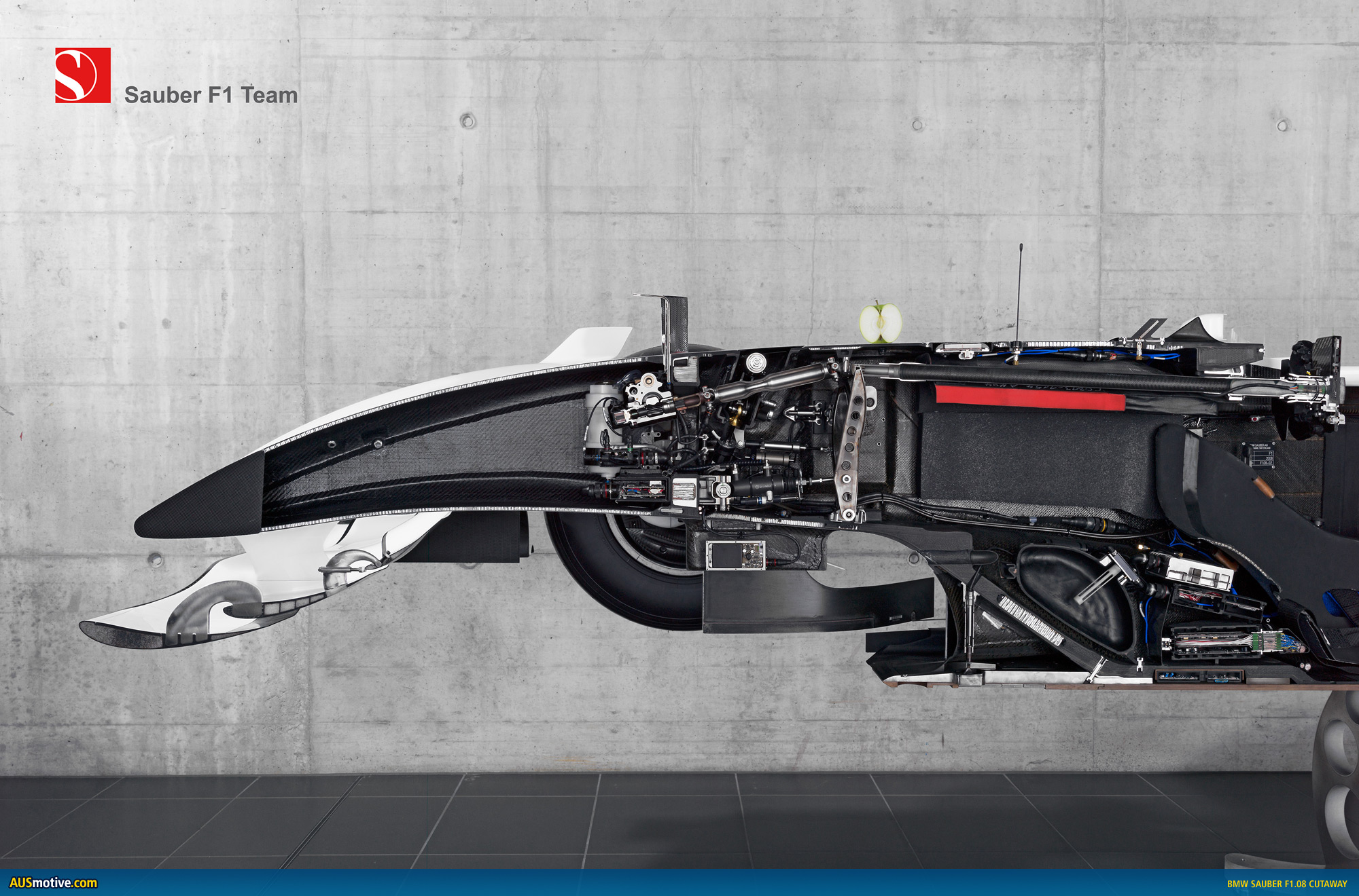

http://www.ausmotive.com/F1/2012/Sauber ... way-07.jpg
I fully agree with you. The post you quoted was a reply to the user above, who claimed it was "another blunder by the designers that significantly handicaps the aero performance of the car by blocking air to the diffuser. "
It's detrimental because it blocks air to the undercut/diffuser. Although it's unclear at this point if it's for driver or battery cooling, even if it is the former, the ideal location would be on top of the monocoque like Mercedes. If you have photos of any other car on the grid with a similar located duct please do share.
