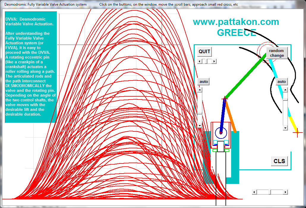

The question is whether the combination of both cycles (spark ignition and compression ignition) in the same engine adds the advantages of both “worlds” without adding their limitations / disadvantages / issues.
For instance (quote from Wikipedia at https://en.wikipedia.org/wiki/Helical_camshaft) :
“There is no physical reason why a Helical Camshaft could not be the “driving” cam in a Valvetronic-type oscillating cam setup. (But it would be quite complex and the Valvetronic part of the arrangement would limit the Helical Camshaft's high RPM capabilities).
The result would be an almost unbelievable array of possible duration/lift combinations.
End of quote.
The DVVA (desmodromic VVA, more at https://www.pattakon.com/pattakonDesmo.htm) :
does exactly this, providing “an almost unbelievable array of possible duration/lift combinations”:
without the limitations of either the Helical Camshaft VVA (and has a lot) or of the BMW Valvetronic VVA.
Thanks
Manolis Pattakos

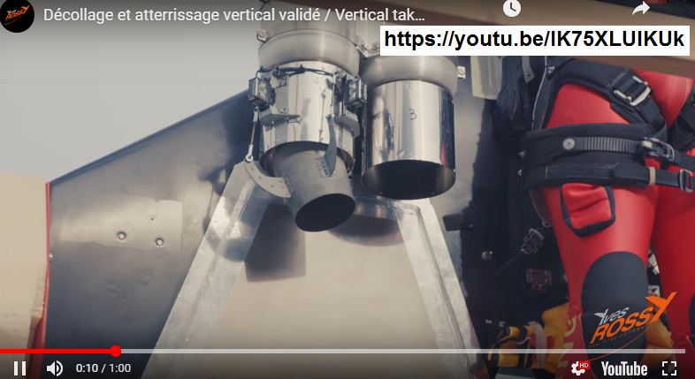

Yves Rossi is not taking off from the ground vertically. The pitch and diameter of a propeller determines its operating speed and thrust. Why do you think helicopters have such a large diameter rotor (hint: it's a wing)? I give up; you don't want input.
manolis
manolis
107
Joined: 18 Mar 2014, 10:00
Hello Rodak.
You write:
“Yves Rossi is not taking off from the ground vertically. The pitch and diameter of a propeller determines its operating speed and thrust. Why do you think helicopters have such a large diameter rotor (hint: it's a wing)?”
Quote from https://newatlas.com/aircraft/jetman-yv ... d-takeoff/
Jetman Yves Rossy can now take off from the ground ... autonomously
Now, with four new, more powerful Jetcat P550 turbine engines on the wing, he's now got enough vertical lift to fly straight upwards at up to 180 km/h (112 mph) – see the video below – and has been working with a Swiss team to develop an autonomous, self-balancing vertical takeoff system…
End of quote.
Think how many times smaller “propellers” than the Portable Flyer are those used by Rossy.
Think also that the only means Rossy has to control his vertical take-off / landing (i.e. when his speed is insignificant) is some control-fins (ailerons?) at the bottom of his external turbines:
These control-fins were absent in the conventional (non able for vertical take-off /landing) Rossy’s Delta Wing JetPack because he was always moving at a high speed into the air, and was using his head / limbs as his only control means. And they were more than enough for controlling the flight.
Now, until he reaches a high enough speed (say, 60mph - 100km/h) he needs control fins for the control of yaw, pitch and roll.
Now think that the pilot of the Portable Flyer is permanently (from before the taking off until the landing) into the high speed downwash from the propellers and can use his head / limbs for the pitch / yaw / roll control and for stability.
If it is still not clear, let me know to further explain.
