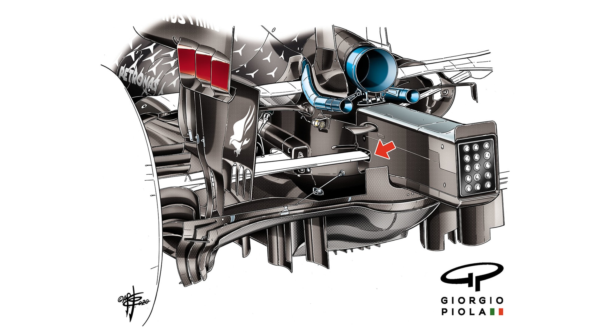

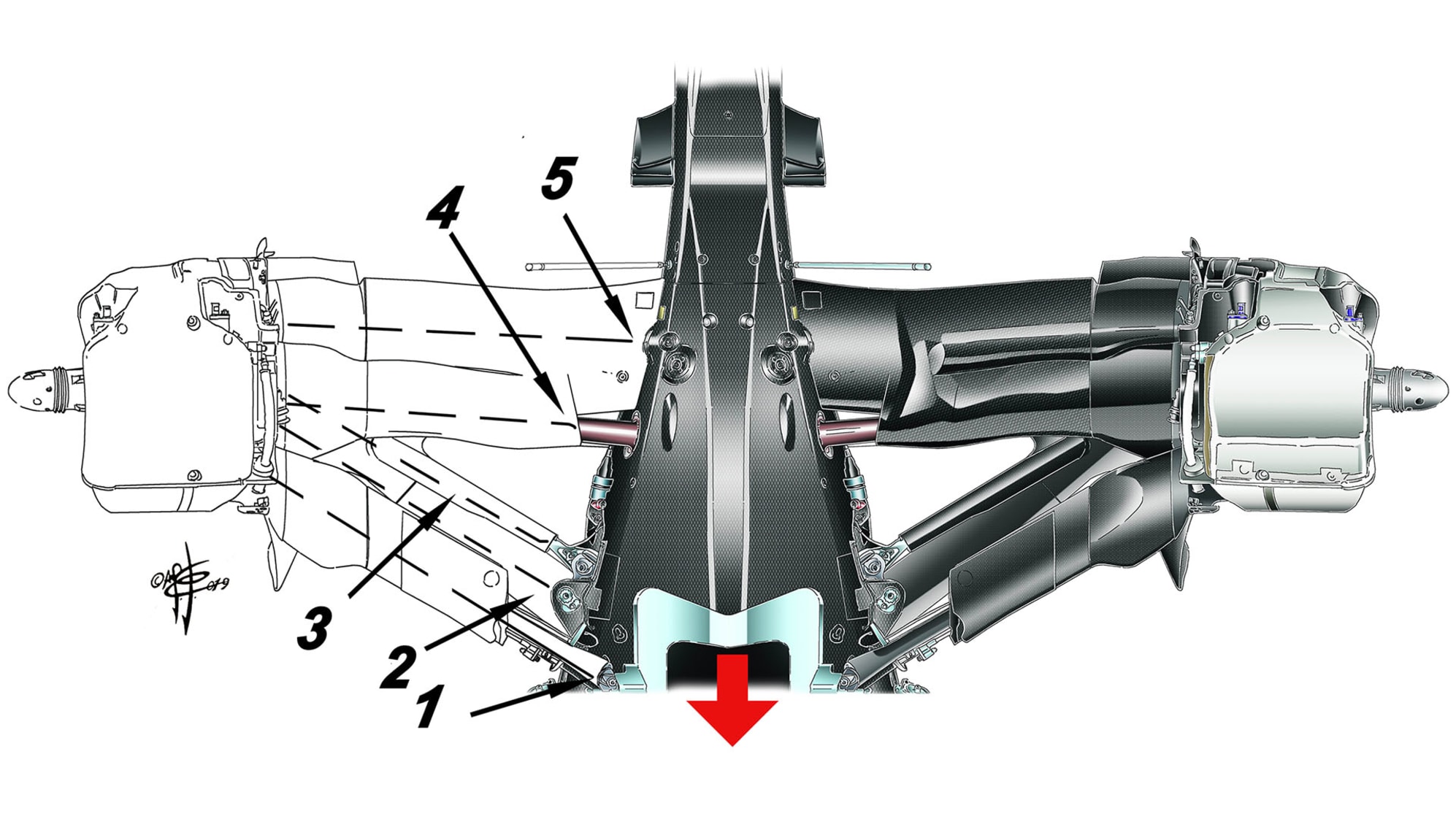

Can somebody explain this please?
https://www.formula1.com/en/latest/arti ... GJ2TZ.html
What is the difference between this (W11)
And this (W10)
Wroom wroom
556
Re: Mercedes W11
See where the leading leg of the lower control arm is? Right beside the driveshaft. It must pushed rearward. The trailing leg is also far back.
Compare redbull
597
Re: Mercedes W11
There is also that it has been raised relative to the previous one, I think. That's helped free up space above the diffuser to help airflow.

Re: Mercedes W11
MtthsMlw wrote:
22 Jul 2020, 11:07
One of the few things where it's immediately clear what it's purpose is and where you can see how it improves performance.
It also looks like it turned into a multi-link suspension. The lower control arm is actually two separate arms now.
