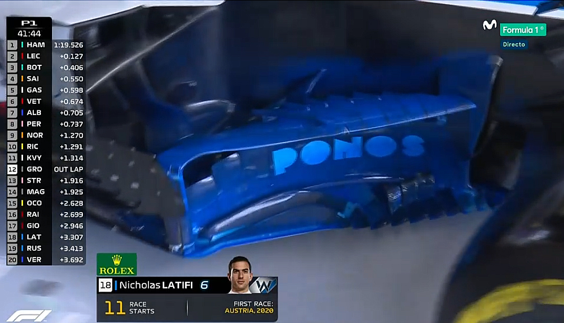

Williams tested a modified version of it´s barge boards during FP1.
It has a new connection to the chassis that seems to produce a bit of downwash to guide more air under the floor and to the diffusor. Also at the outer edge of the barge boards has some small modifications. The front vane has a slightly different conture at it´s front edge and the vertical strakes of the boomerang have a different angle at the lower end.

That is a photo from winter testing.

Re: Williams FW43
PlatinumZealot wrote:
Sat Nov 14, 2020 10:29 pm
The top one definitely isn't
