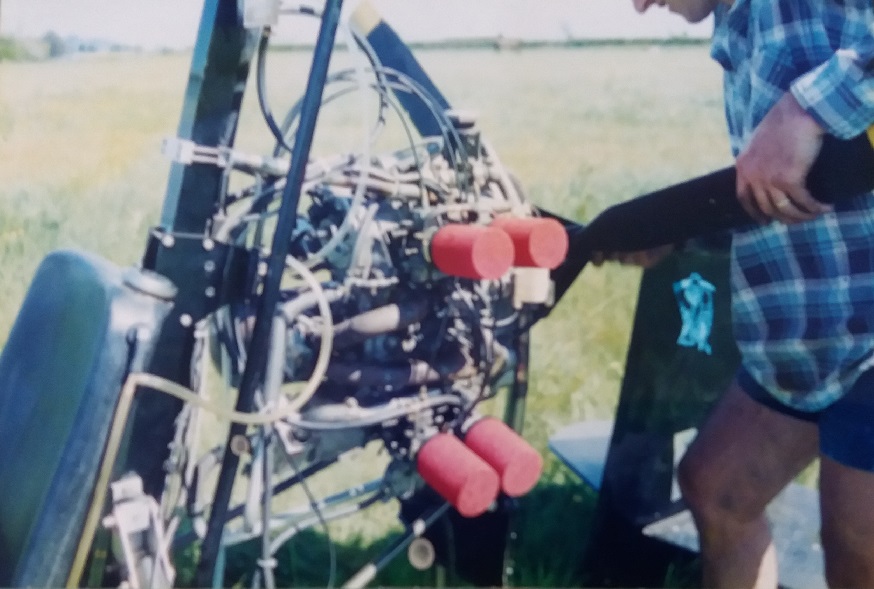

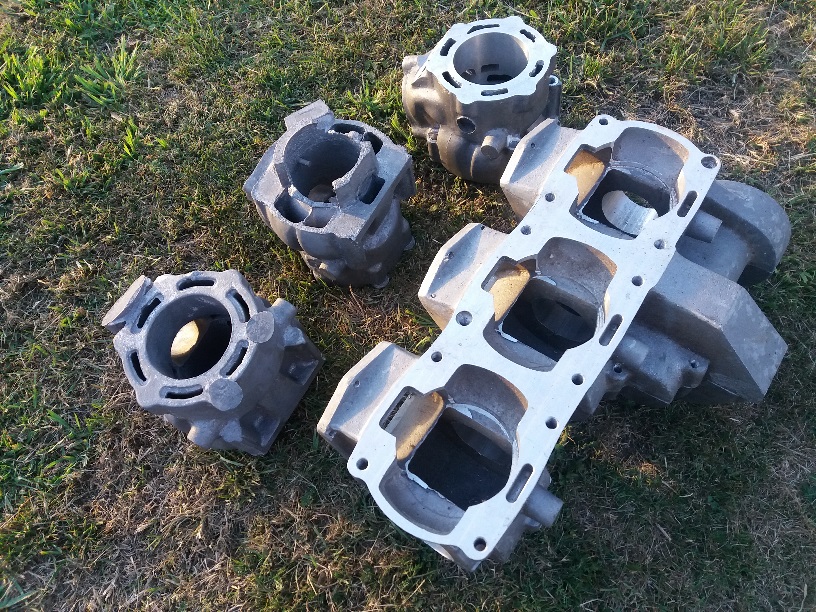

All my own, actually cast two of these cases but realised I couldn't afford to fill it with all the hardware needed. So I cut one down to a two cylinder, the original engine in my gyro, the one I ended up using as a counter balancer test.

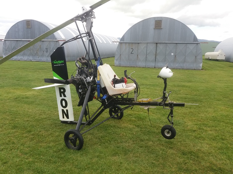

New cases for the gyro now with internal counterweights.
This one three cylinder case was to go in my two seat gyro but nothing has happened yet, money and time deficient.
Cylinder spacing in not compromised like the skidoo engines, room for big sweaping transfer ports. Engine was to run two up one down firing not 120 degress, easier to balance.
Case reed, bore and stroke not so good at 80 bore 70 stroke, thats 1050cc .
Was planing on not running carburetors, TPI, there is room just and it would be my new mk2 system.

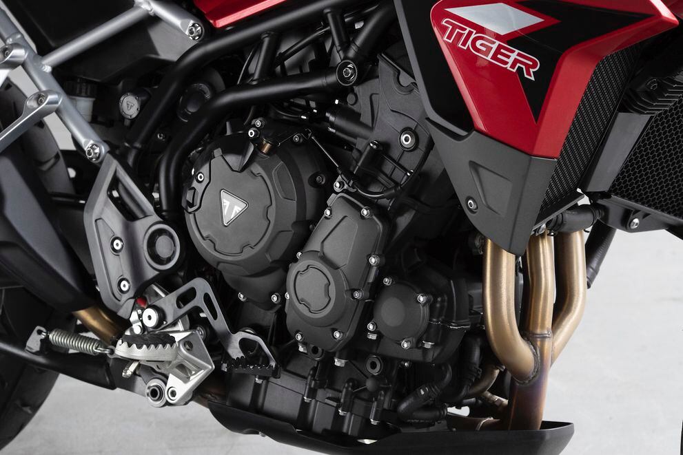

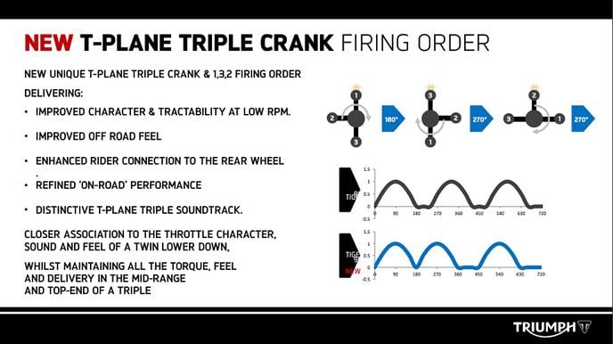

An alternative solution is to use the “T” crankshaft of Triumph.
This Tiger 900’s “T-Plane” crankshaft places crankpins one and three 180 degrees apart, with the number-two crankpin 90 degrees from the others, defining a “T.”
But in the case of this Triumph, engineers increased the firing interval on two cylinders to 270 degrees by closing up the third interval to 180—not a big change, 12-1/2 percent. Yet without testing the result ourselves, who can say how much this change improves “feel”?
Ah, but doesn’t such a change require a balance shaft?
Even-firing inline-triples already need a balance shaft to cancel what would otherwise be a substantial side-to-side rocking motion, so the only change needed is to reangle the eccentric weights on the already-existing shaft.

The last paragraph of Kevin Cameron is wrong.
Because if you just reangle the eccentric weights on the already-existing shaft, you can’t have the same vibration-free quality as you have in the even firing triple (that with the crankpins at 0, 120 and 240 degrees); the architecture of the latter cancels out all inertia forces while the architecture of the first leaves unbalanced heavy inertia forces of first order and of second order.
You can think of it differently: the T-plane triple is actually your twin (with their cylinder axes at double distance) plus a central cylinder at 90 degrees phase difference. The first order balance shaft can cancel out the inertia moment of the pair of the external cylinders (leaving only a second order unbalanced inertia force) but it can't do much with the central piston.
