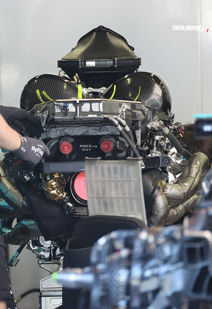

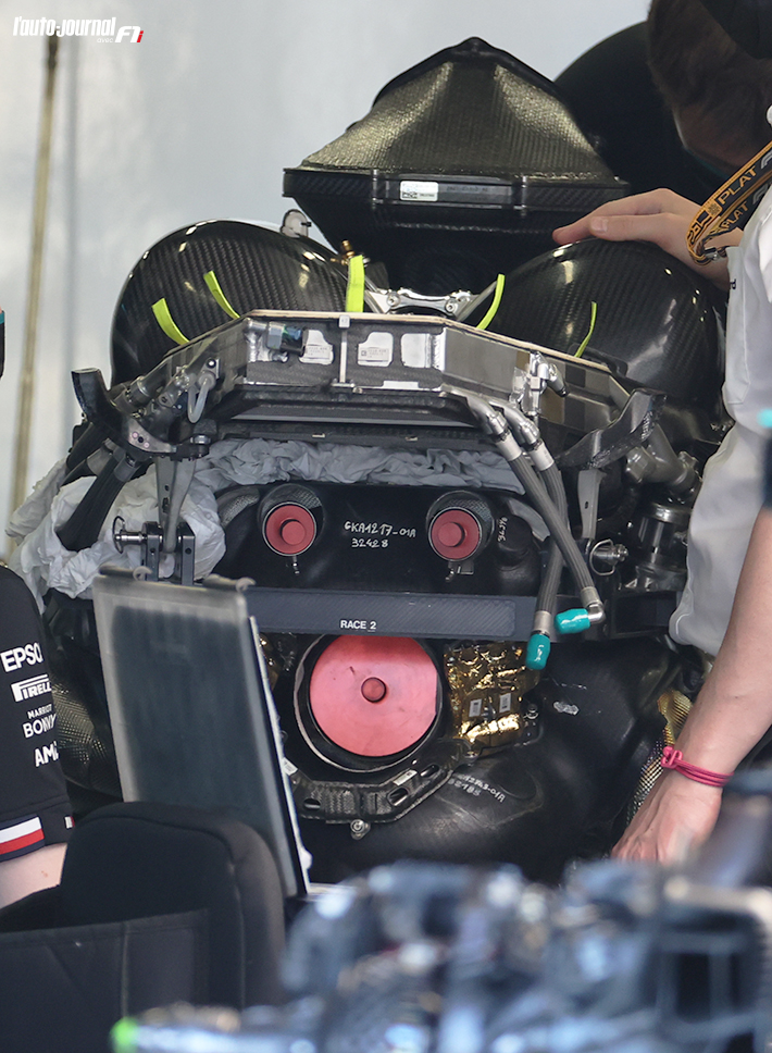

Nice pics from the Mercedes PU in Baku:
From earlier in the year (April):
via @NicolasF1i
