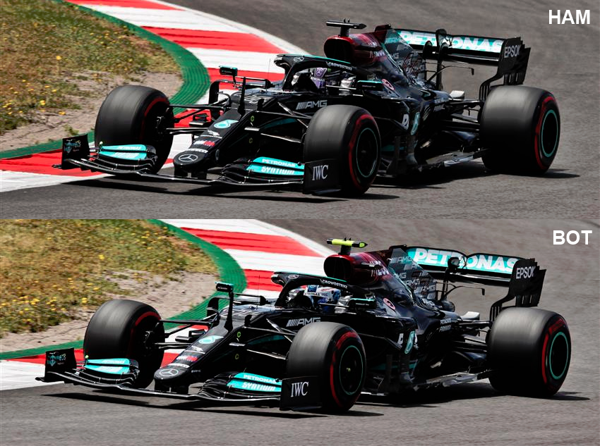

Was Lewis running less rear wing than Valtteri today ?

Yep, different configuration

https://www.racefans.net/wp-content/upl ... N-01-1.jpg
https://www.racefans.net/wp-content/upl ... N-38-3.jpg
Thanks for the pics.

Is BOT's rear wing higher downforce, but offers more DRS benefits (due to taller/wider flap)?
Re: Mercedes W12
Higher downforce. No DRS benefit. The top speed dpesnt get higher but he will feel a bigger difference in speed when it opens up.
One of the advantages of being able to live with more rear tyre slip means a driver can take this low drag rear wing option. Sometimes it can back-fire though.

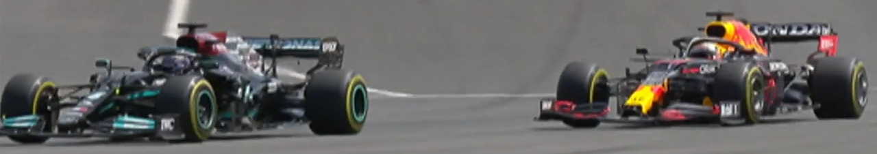

I know the rake subject gets done to death, and I`m sorry about the poor picture quality, but I found this quite interesting.
Pretty much all the way round the corner the 2 cars were pretty much identical on the angle.

Basically RB is more loaded on this photo ( front wing endplate proximity to the ground) merc is stiffer

The suspension set up of the cars is different, but when the cars are actually travelling at speed I don`t think the rake angle is that much different [static to dynamic].
When the cars are static, the angle is more on the Red Bull, just watch the pass video [4th down] from the link below and pause -> start -> pause around the 17/18 second mark. The rake angle of both cars is very similar at all stages of the corner.
https://www.skysports.com/f1/news/31381 ... lton-trust
I`m just wondering if this is one of the reasons Mercedes seemed to have clawed back some performance and Aston Martin still seem to be floundering.

As posted before ,static rake does not tell you what happens dynamically .
oversimplified you could say , more rideheight allows for more bump travel and you can soften springrate.
This is of course not taking into account
spring compression by aero generated vertical load compressing the springs .
