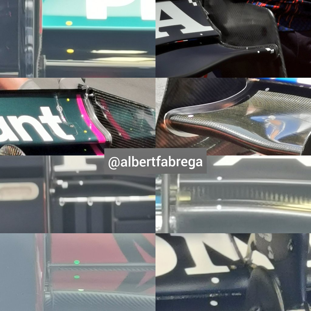

Agreed, although I probably wouldn’t have used “round” stickers and instead, checkered ones since it would have assist on accurate measurements.
Heh ... RBR has square checkerboard stickers AND white dots
Ferrari, Mercedes and Aston have complementary (?) coloured ones (relative to the base wing colour), most dark (black-ish) ones have white dots.
