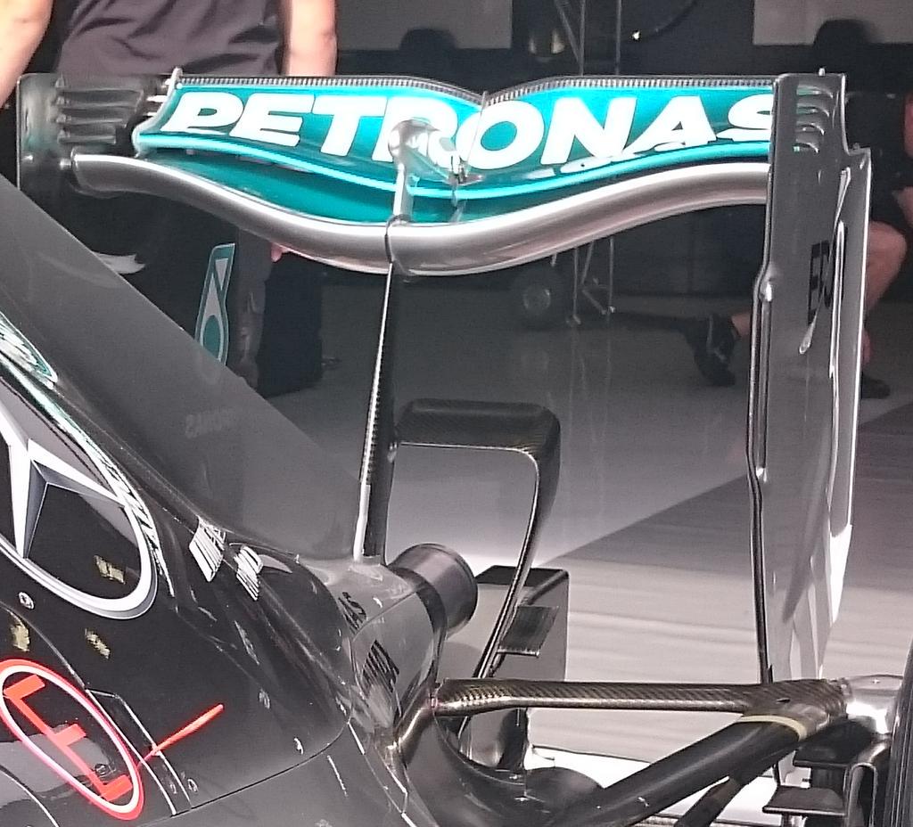

Looks like the whole rear wing is different now, is this Spa only or could we see it again in say Russia/Mexico?

monza too maybe
Re: Mercedes AMG F1 W06
Via AMuS

Triple slot at the bottom of the rear wing plate, usually just the two.

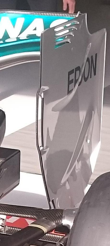

Different canard on the endplate, very similar to what they ran last season.
