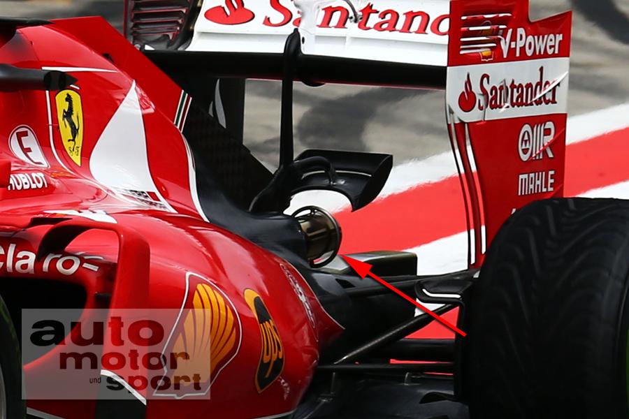

What kind of sensor is it?

Possible sensor for measuring exhaust vibrations?
