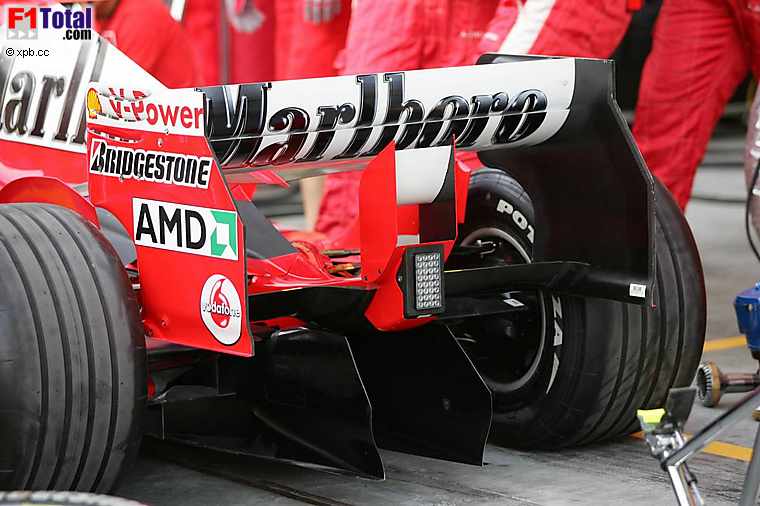

IIRC monkey seats first appeared in 2005 as means to try and recover some of the losses brought up by downsizing of diffuser brought up by rules for 2005. Also, IIRC that was the reason why Ferrari started season with F2004M instead of F2005 because that rule was introduced quite late and they had to redesign their gearbox because it wouldn't fit with new diffuser rules

Cuky wrote:IIRC monkey seats first appeared in 2005 as means to try and recover some of the losses brought up by downsizing of diffuser brought up by rules for 2005. Also, IIRC that was the reason why Ferrari started season with F2004M instead of F2005 because that rule was introduced quite late and they had to redesign their gearbox because it wouldn't fit with new diffuser rules
http://www.motorsport-total.com/bilder/ ... o/z076.jpg
Minardi is the team that implement them first in 1995 I think it was at Monaco GP
It is mounted on different position because back then wings were low and there wasnt more room at the crash structure

I don't really think what Minardi had in 1995 had the same purpose as those we see today.
In 2009, most notably Toyota, had both monkey seat and small wing on top of the main RW in that same width area that allows for monkey seats.
My god that is a beautiful car... Sorry to get off topic

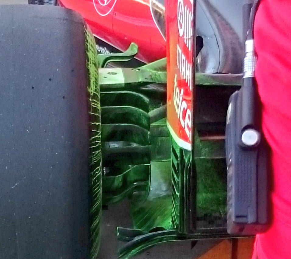

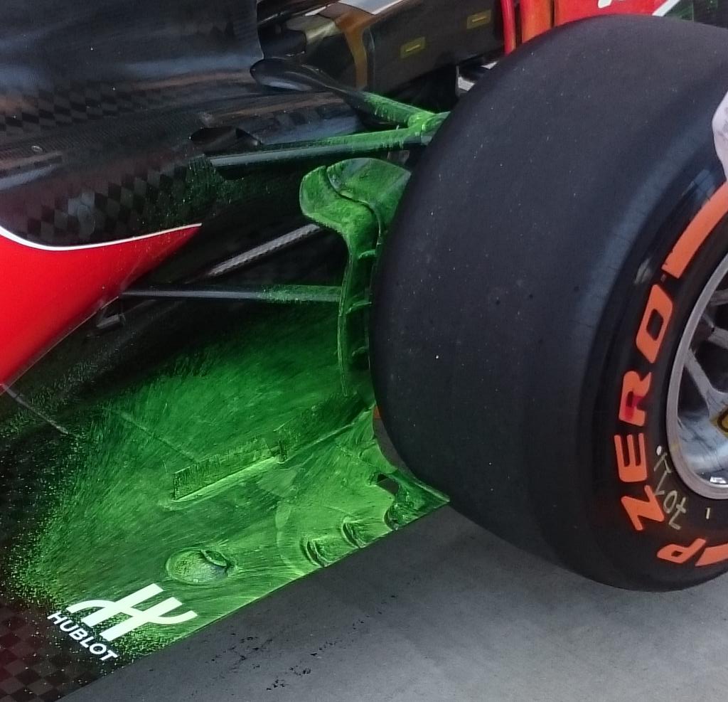

Evaluation with flow-vis:
