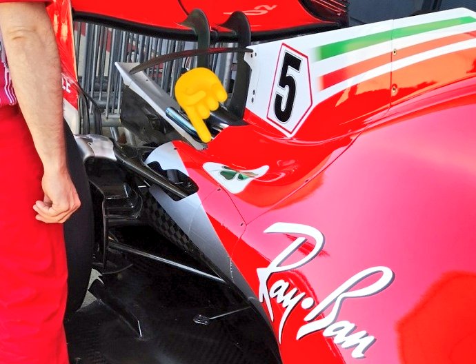

Re: Scuderia Ferrari SF71H
Engine cover is reshaped.
Good effort on floor edges, strengthening edge vortices and maybe even increasing downforce a bit. Must be a pain in the... to assemble these floors nowadays.
I thought you couldn't have slots that close to the Centerline of the car, as it would open up the door to use slots at the rear of the floor before the diffuser transition to actually open up as a double diffuser...
Zynerji wrote:
05 Jul 2018, 16:50
I don’t think it’s any closer to the centre line than the last one - it’s just a more close up picture. These slots are smaller/more numerous, but they don’t take up any more real estate.
Never mind... My phone screen brightness was turned down, and I didn't realize the left side of the pic was a side by side, I thought those slots were under the side pod. My mistake!
As far as I know, FIA made a loophole in rules, where they kept the floor designated as a "single closed contour" in plan view only until last 100mm. Cars were allowed to be 1400mm wide in 2016 and 1600mm wide last year, so 100mm on each side is likely unregulated.
MtthsMlw wrote:
05 Jul 2018, 16:25
https://pbs.twimg.com/media/DhWQ1DIW0AA2wpR.jpg:large
That's a tighter engine cover, thus a slimmer rear end, right?
LM10 wrote:
05 Jul 2018, 18:04
MtthsMlw wrote:
05 Jul 2018, 16:25
It's just tighter around exhaust
