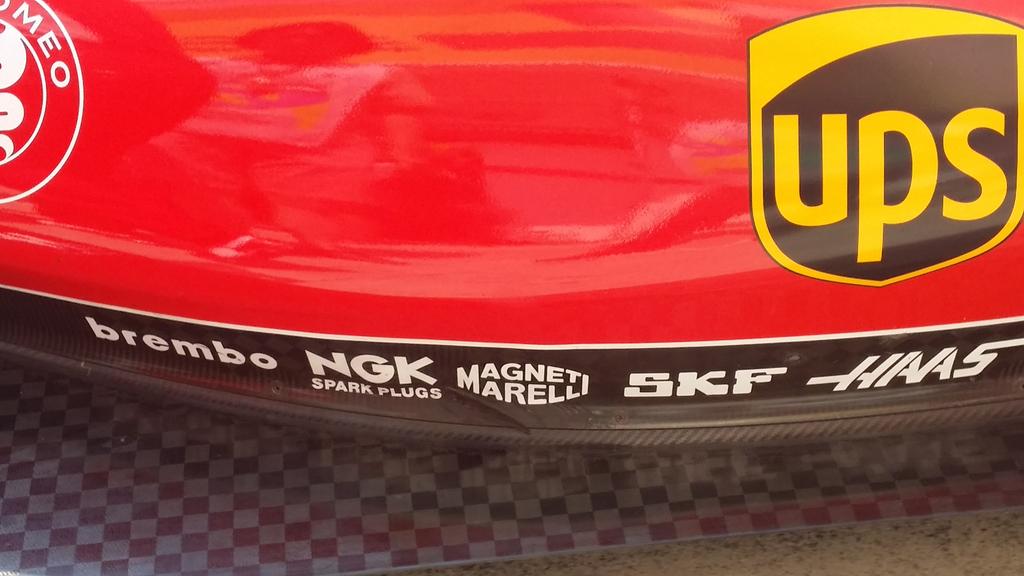

Vis AMuS
Tiny aero flick below the Marelli logo
Via @ScarbsF1
siskue2005
70
Joined: 11 May 2007, 21:50
Re: Scuderia Ferrari SF15-T
isnt the sidepod new? huge bulge over the claro logo
