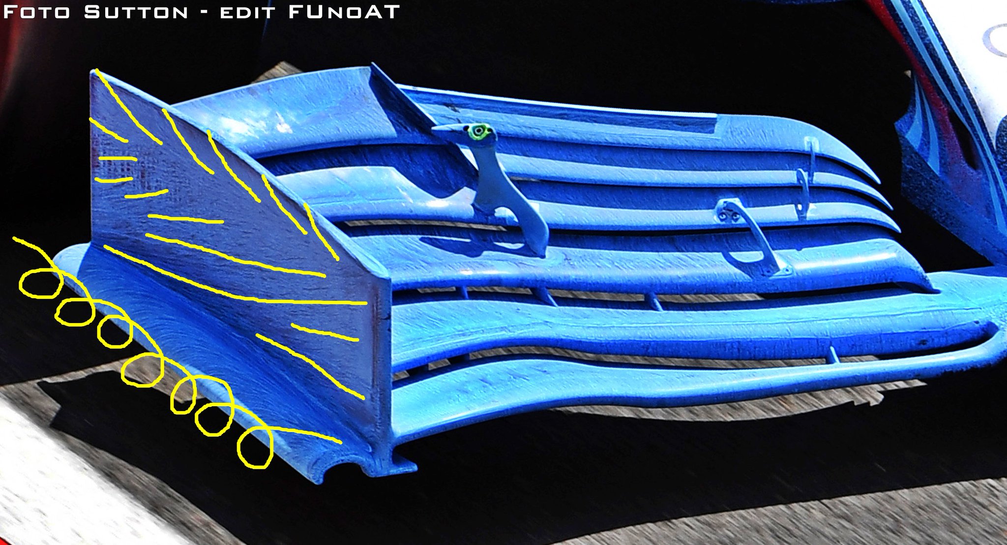

So these new wings are basically the same shape and form as the old wings. Like, 95% 8) identical in general shape, sans cascade elements. How does this improve things. The two main vortex structures coming off each side of the wing are still gonna be there. Seems like a compromised, minimal approach to solving the 'problem.' Maybe a good consensus was never reached by FIA and the teams and this is the result. If the real reason was cost-cutting/simplification/parity, this would make more sense to me.

Flow-viz close-ups of the Williams 2019-style FW:
Via FormulaPassion.it

ScrewCaptain27 wrote:
31 Jul 2018, 19:46
Upper surfaces isn't all that interesting - AND most of those are just after the paint was sprayed on in the pits.
