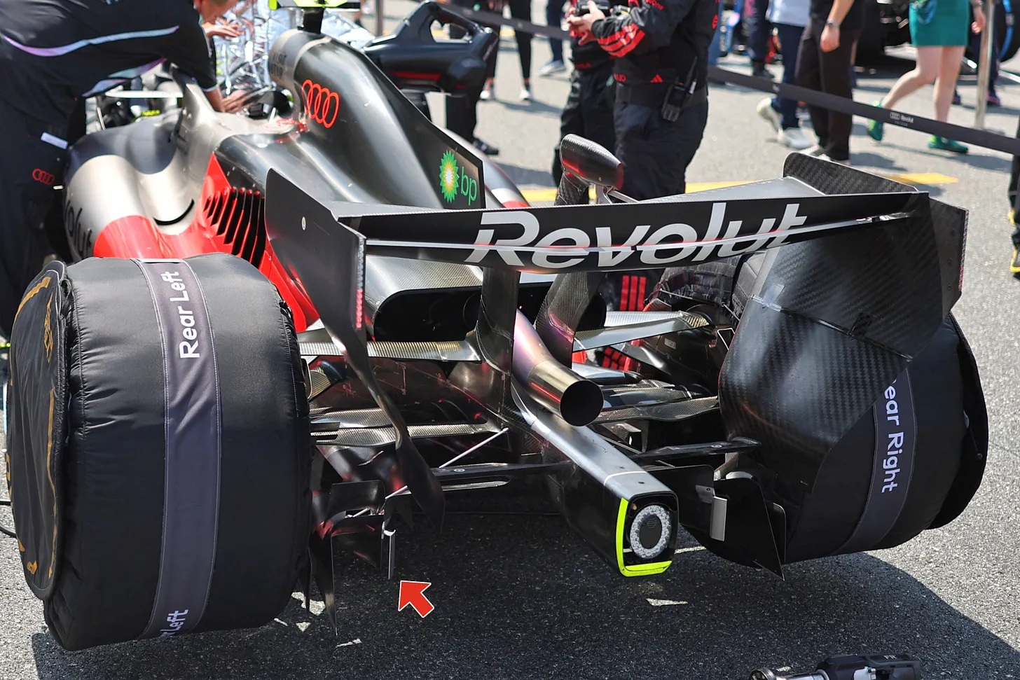

That's a nice solution. Let's see if they dispense with the lay-flat wing like Alpine did. It appears to still be on the car.

It seems like Audi would have a very easy time adopting the Red Bull sidepod solution as they are the closest to it in practice. They have the gulley but lack the hard shoulder which is seen as a loophole.

No active aero components this weekend.
Well Rbr clearly copied Audi on the bodwork tail. Surely Audi is better of with what they have
