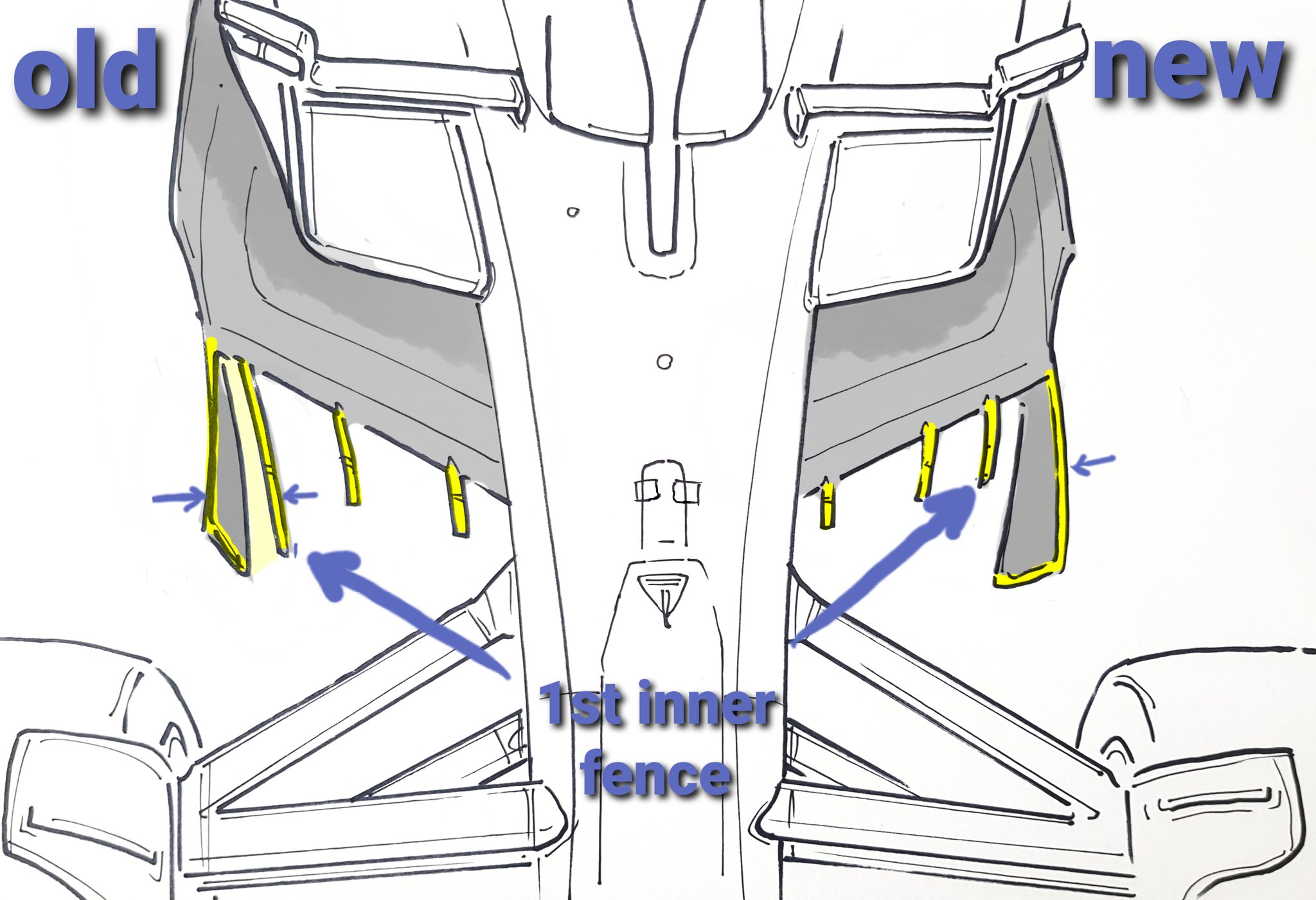

RB have ditched their double bargeboard arrangement at their floor edge. Will need more photos to 100% confirm but I believe they now use 3 of their fences for managing underbody flow, as the other teams also do
Silverstone to compare. You can see here they only use 2 floor fences under the floor, and 2 taller outboard fences. Probably the largest floor change RB have made since the start of the season.

Re: Red Bull RB18
Yes you can see the old setup here.
New:

https://i.imgur.com/TxxmvDB.png
Floor Fences
Reason for change: Performance – local load
Difference: “Revised fence geometries extending to the floor edge”
Description: “The fence layout has changed to re-distribute the local pressure distributions to improve load whilst maintaining the flow stability.”
Rear Corner
Difference: “Revised upper wing cascade.”
Description: “A revision to the upper winglet cascade to gain local load without disruption to lower wing cascade or the adjacent brake duct exit.”

Re: Red Bull RB18
Well, doesnt that make AM look stupid ;)
This change must have been already in the works at the time AM brought their double bargeboard...
