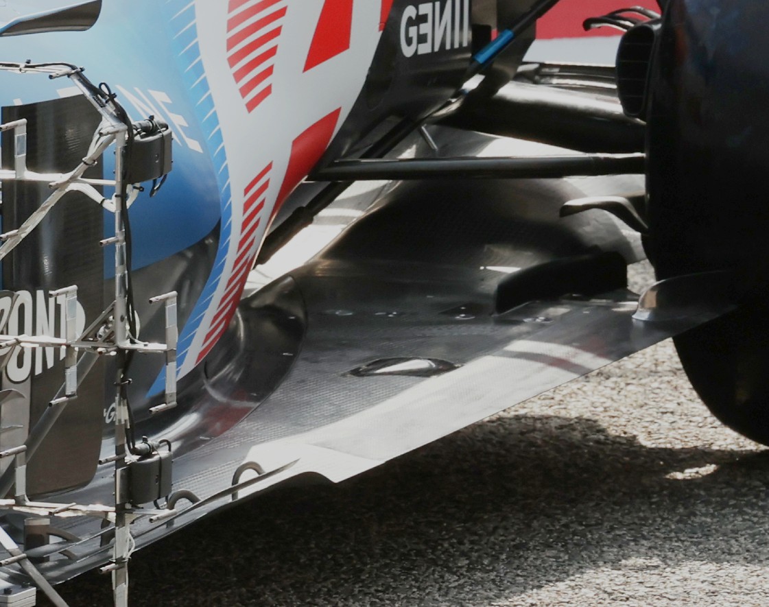

The very exposed boat-tail area under the gearbox
https://pbs.twimg.com/media/EwczLD2WgAA ... ame=medium
I like what they've done there....
The way the exhaust points down will really energize the diffuser air.
The exhaust? Image

Floors in order of appearance
Well it's the same floor and they just changed the fins in front of the rear wheels...
Then, in its 4th version, they've cut a triangular portion and put this vane generator, AT-style (blue arrow)
Pics from Racefans, Nextgen-auto, Skysports

Blackout wrote:
16 Mar 2021, 12:08
diffuser wrote:
16 Mar 2021, 02:47
Blackout wrote:
15 Mar 2021, 16:37
The exhaust? https://www.starwars-universe.com/forum ... es/paf.gif
Poor choice of words, I guess, the way the heat flows out and is directed by the PU cover.

diffuser wrote:
16 Mar 2021, 14:16
Blackout wrote:
16 Mar 2021, 12:08
diffuser wrote:
16 Mar 2021, 02:47
Would you actually want that? The air from the hot exit is usually quite low energy/dirty, no?

raymondu999 wrote:
17 Mar 2021, 02:04
diffuser wrote:
16 Mar 2021, 14:16
IMHO, heat will always thicken the air up, make it act like there is more of it(energies it). Improving the airflow under the PU cover was probably something they had in mind when they redesigned it over the winter.

Re: Alpine A521
Yes the higher temp will obviously mean there’s more heat energy in that air, and of course thinner as that air expands... but it’s also lost a lot of energy going through the internal aerodynamics of the car... and won’t be a clean flow either. In any case I have very little knowledge of aerodynamics.
Perhaps someone else may chip in?
