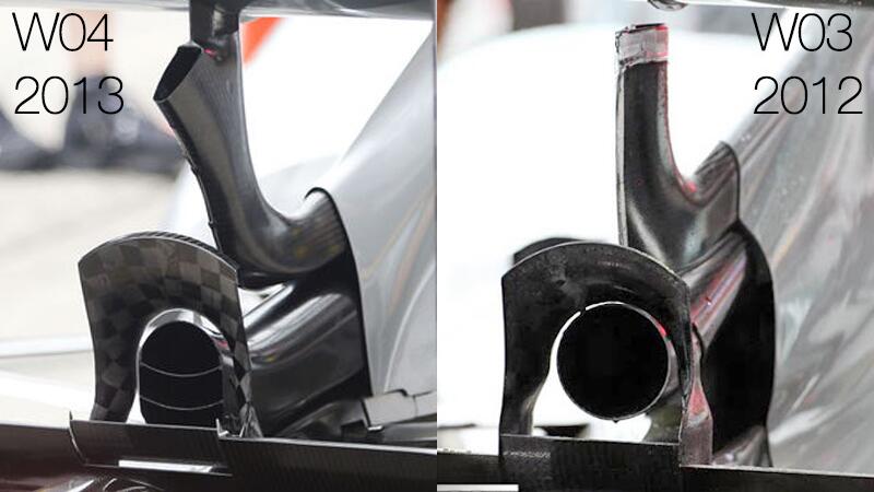

Mercedes have tested a new evolution of the passive DRS, more commonly known as drag reduction device. The team trialled it on Nico Rosberg's car early in FP1 before removing it to get on with more conventional development work. Last week, Lotus also revived its DRD and even debuted it in the race on Kimi Raikkonen's car.
Mercedes' new version clearly underwent development since the Barcelona winter test where the team last tried it. The car configuration with DRD features an additional arc-shaped inlet just behind the airbox, followed by two even smaller inlets further downstream. Both these inlets are not present on an F1W04 car without DRD, hence it looks like both of these are used to powered the drag reduction system.
As indicated, air flows through ducting to the rear of the car, either through the upward duct that helps stall the rear wing, or through the neutral duct that exits underneath the monkey seat, just above the beam wing. Both ducts are likely meeting underneath the bodywork to form a fluid switch which then forms the core of the device to make sure the rear wing isn't stalled when maximum downforce is needed.
Interesting as well are the different outlets compared to the Lotus version. While Lotus previously had the upward duct connected to its rear wing but then decided to leave a gap, Mercedes went the other way around and now has its DRD duct connected to the bottom of the rear wing. This duct also features different outlet channels to help increase the stalling effect.
The neutral duct under the monkey seat also features a few internal fins, helping to condition the flow as it is extracted by the monkey seat, acting here as a mini diffuser.

I am not sure if this interpretation is correct. In the middle of the pipes you can see a bulge, there must be the fluidic switch, and I think the upper opening is only for the switch to operate. The larger one collects the air which passes through the switch in the direction either to the wing or the beam wing.

sucof wrote:I am not sure if this interpretation is correct. In the middle of the pipes you can see a bulge, there must be the fluidic switch, and I think the upper opening is only for the switch to operate. The larger one collects the air which passes through the switch in the direction either to the wing or the beam wing.
I agree. The smaller one is the switch, analogous to the hole that fed the pipe that the drivers would cover/uncover in the f-duct systems.
The larger opening feeds the system and is directed to either of the tail openings depending on the flow through the smaller switching opening.

I thought the larger opening behind the airbox was just for secondary oil cooling etc?
I'm sure the Ferrari has/had something similar?

krisfx wrote:I thought the larger opening behind the airbox was just for secondary oil cooling etc?
SkyItaly's commentator was in the Ferrari box asking if massa's car was ok or had problems too (FP1), when the cameraman focused on alonso's one and the second opening is for cooling too, i think gearbox at least

On the Ferrari it feeds air to the gearbox oil cooler. It's radiator is visible from behind.

So is this not the same for Mercedes? I've not seen pictures under the engine cover to prove/disprove this
