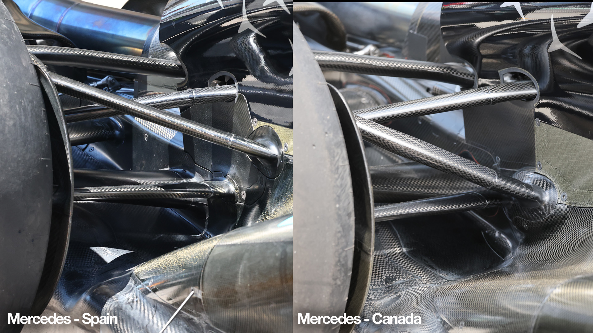

Lasssept wrote:
13 Jun 2025, 22:08
https://pbs.twimg.com/media/GtWCkYCWkAA ... name=large
@RosarioGiuliana
A lot more anti dive in that upper arm. And it seems the hard point has been pushed out more resulting in a shorter upper arm.
For Sure!!

ringo wrote:
14 Jun 2025, 04:35
Lasssept wrote:
13 Jun 2025, 22:08
@RosarioGiuliana
But are we sure there's a new suspension? I saw the Imola document, but Mercedes didn’t declare any new suspension—just new bodywork. Could it be an optical illusion caused by a slimmer engine cover? Unfortunately, the photos aren’t taken from exactly the same angle.

Farnborough
Farnborough
125
Joined: 18 Mar 2023, 14:15
Re: Mercedes W16
Its not just that movement indicated in the image by applied graphic though.
That front top leg of "wishbone" has been relocated to what was the site of lower front link, more or less. Possibly using that original pickup point for inner "new" location.
Bottom front link seems to have moved backwards in relation to pushrod link in purple colouring too.
Slightly shifted image perspective doesn't give totally accurate view to analysis for us observers.
Braodly speaking .... looking from nearside rear wheel it appears to have the chassis ends of suspension collectively rotated anti clockwise is a way of describing it. I know its not that simple, but gives reasonable visualisation of overall change.
If they re-purpose the chassis location mount points, then possible without rear structure "architecture" changes. Others have done this before by switching link location similarly.

I made this hypothesis: at the rear, they have what they previously had at the front — the ability to move the mounting points. We'll see in the upcoming races if they go back to a standard solution, which would clear up the doubt. If they have a modular setup with two mounting points on the chassis, that would explain everything. So, not a new suspension as some suggest, but the same one that can be adapted depending on the track

zioture wrote:
17 Jun 2025, 10:35
But it's really strange — I checked from here back to the start of the season, and Mercedes has never announced any updates to the rear suspension. But is this even legal?
Simone Resta: I mean, first of all, we brought to Canada a development on the floor and also on the front brake duct. And also, we tested again on Friday a rear suspension that was tested before in Imola. And then we confirmed it on Friday. And we raced it on Saturday and Sunday.

According to Jon Noble on The Race podcast, the reason Mercedes’ suspension was not listed on the update declaration is that only aerodynamic upgrades are required to be listed. Purely mechanical upgrades don’t need to be declared. So if anyone is still wondering, that’s why.
I was not aware of this, but it makes sense with how McLaren’s rise to dominance over the last couple years has been so mysterious for some. They probably don’t have the best car aero, but clearly have the best car mechanicals. And much of that mechanical development has been under the radar.

That’s a good point — it does seem strange. I’ve been looking into the regulations too, and from what I understand, if a suspension element is repositioned or reshaped in a way that affects airflow, it should technically count as an aerodynamic update. In the photo above, you can clearly see changes near the wheel area, and the wishbone itself looks different in shape. McLaren declared their updates for much less in the previous race, so this lack of transparency from Mercedes raises some questions.
3. But the boundary is blurry
The regulations state that aerodynamic components or bodywork influencing airflow must be rigid and immobile
. That means if a suspension arm is reshaped, repositioned, or wrapped in a different profile—even if it’s not officially part of bodywork—and it affects airflow, it arguably falls under aero regulation.
