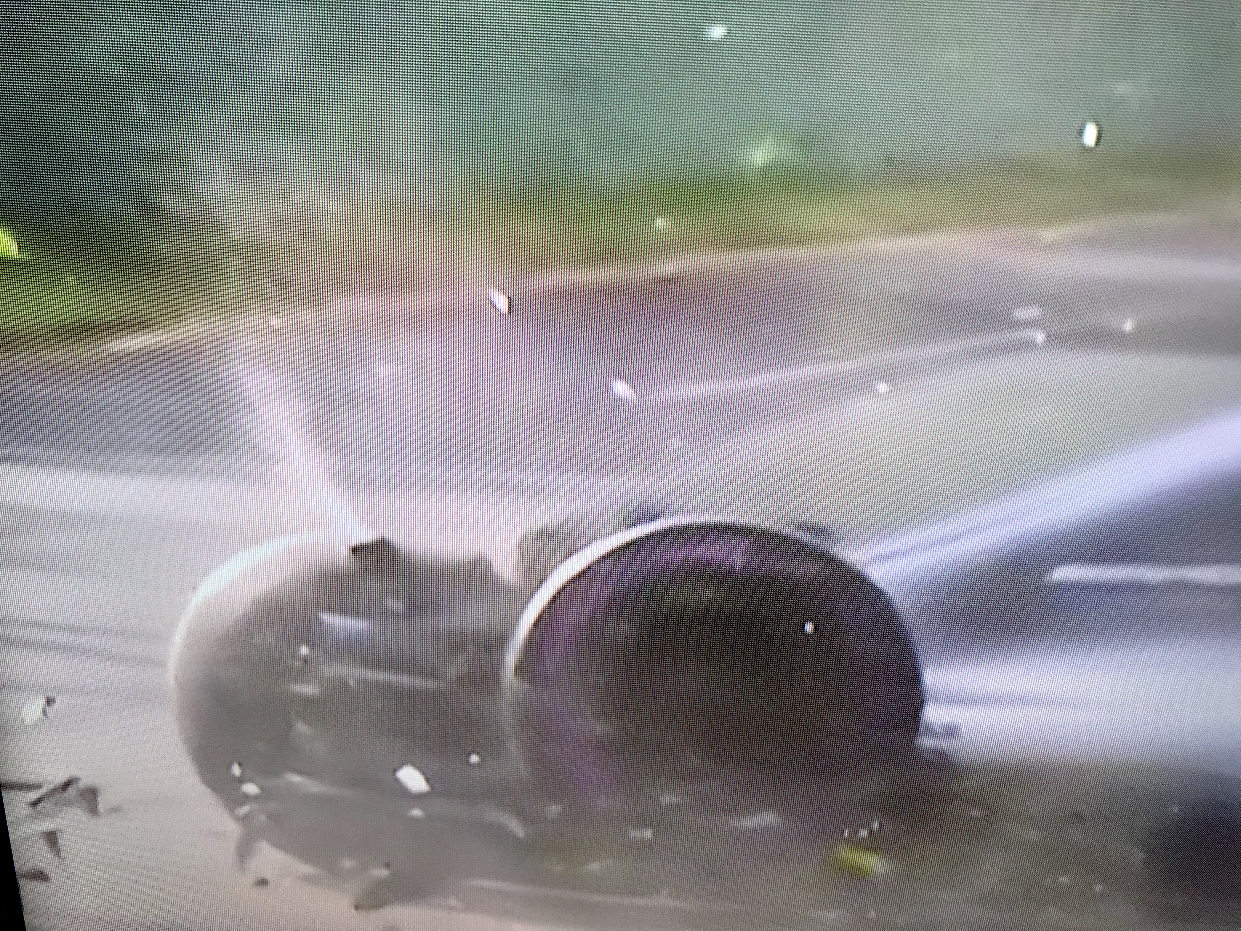

Does someone has an idea what is coming out of the rear wing support? This showed during the crash of Bottas...

Re: Mercedes AMG F1 W09 EQ Power+
Hidraulic fluid?
Bomber_Pilot
Joined: 28 Jan 2011, 14:19
Hydraulic fluid for the drs.

Bomber_Pilot wrote:
24 Mar 2018, 09:18
I watched it over & over & it seemed more like smoke/steam.
Sieper
73
Joined: 14 Mar 2017, 15:19
rileykirn wrote:
24 Mar 2018, 19:53
Bomber_Pilot wrote:
24 Mar 2018, 09:18
Wasn’t it just smoke from the turbo waste gate, the engine was still running. the lefthand waste gate tube got bent upwarts in the crash.
