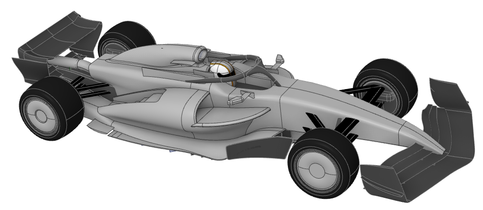

Thank you for your answer, I've got confused as there is a plenum in the "mandated engine" and the AIS looks like air Filter + compressor inlet ducts.
On my side I'm taking advantage of the extra 48h, and running a couple more iteration on the floor + cooling. It's been really fun to design that car, here is our best challenger so far :
Let's say we'll be fighting for points ! :)
After the last race we'll definitely try to developp a bit more that car, as it's really far away from what the front runners are able to do :)
