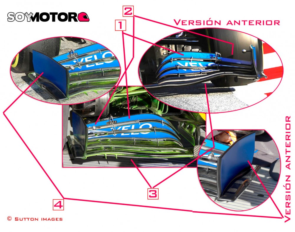

Rake is a bit high again ...
Hopefully front wing updates will help lowering a bit.

You don't want the rake lowered. If they lower the rake, they're likely failing at sealing the floor. It's easier to seal the floor at a lower rake.
The whole idea of the rake is like having an adjustable rear wing. The rear suspension tension is setup to keep the hight at the speeds that they take the high speed corners in. Then squat in the straights where you don't need the DF. As the car squats the rear wing angle leans back and drag is reduced.

When I look at theses pictures. I get the impression that we don't have a S duct there cause we have a rudder underneath the nose. Plus that cape. The cape is pushing down the air worked bythe nosterils and the air coming around the nose is guded by the nose rudder. It isn't really dirty. So why would we need an S Duct? For the boundary layer over the top 30 cm in front of the cockpit ?
Be interesting to have a flowvis of the nose to compare to this ...
