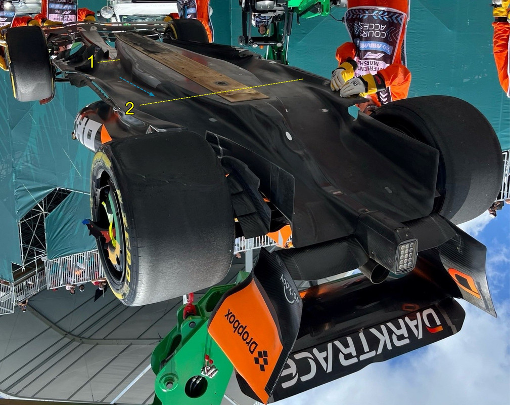

McLaren 2024 MCL38 floor
This is the floor of Miami when McLaren is faster in 2024.
This year, the basic concept should remain the same.
https://postimg.cc/jD623qXp
While the Ferrari is positioned at the front of the floor and immediately approaches the road, the McLaren has a gentle slope towards the rear kick point.
The inside of the tunnel is an inner groove, which contrasts with the Ferrari with the outer groove.
This concept has been brushed up from the Red Bull RB18 and has now been updated to a design that surpasses the original and boasts unbeatable strength.
Summary
In the first place, why is it better to have a kick point (a place where the angle changes as it is closer to the road surface) at the back?
This is because it is easy to adjust the negative pressure of the kick point by adjusting the rear vehicle height.
It is easy to take into account the ride height that decreases due to the downforce of the rear wing, so there is an advantage in terms of settings.
In the case of Ferrari, there is a maximum negative pressure generation point in the center of the car, which must be adjusted according to the front and rear ride heights, which is very difficult to set up.
It can be assumed that the reason why Hamilton cannot run fast is because he is suffering from this downforce balance."
