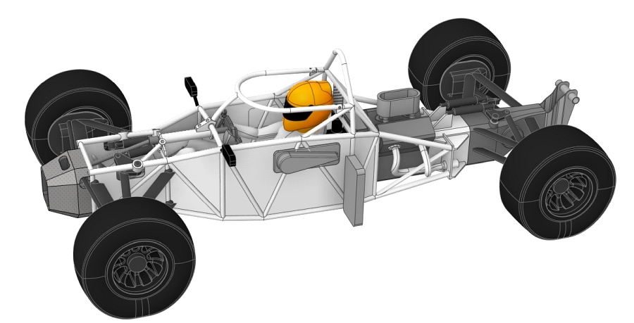

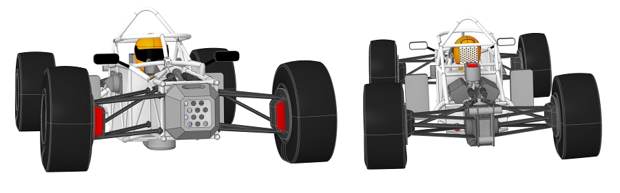

Hi guys, finally an update!
The CAD models of the mechanical part of the car are available n STEP format. Unfortunately I haven't defined the rules yet (based on volumes in which body modeling is allowed), but I'm working on it. All the mechanical parts included into the STEP files (except the bodywork cover and the volumes that define the rules) will be included in the simulations. Theoretically it is possible to run with a naked car.
STEP CAD MODEL Rev001: https://www.caedevice.net/SERVER/Formul ... Rev001.zip
The CAD geometry DOES NOT want to be rigorously detailed, but only to constitute a realistic reference for the design of the aerodynamic features.
Having chosen an "open source" approach, suggestions, criticisms and collaboration are welcome.

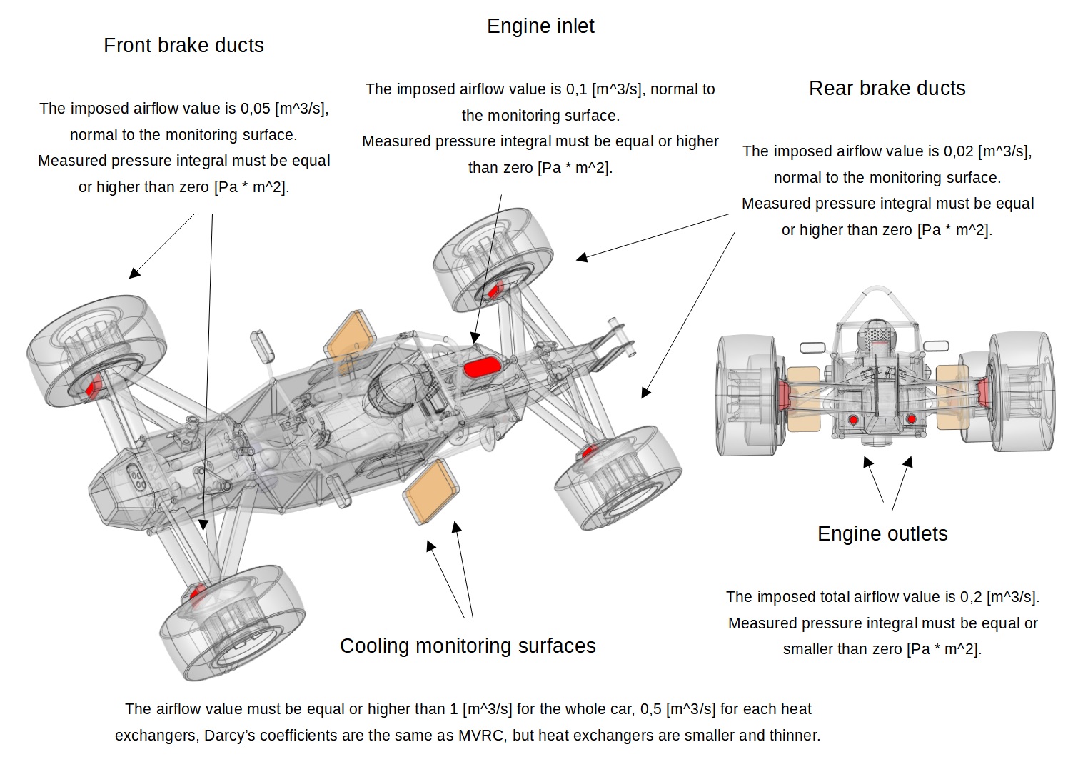

I also publish the images of the boundary conditions (Rev001) to allow LDVH (MantiumFlow) to set the template. Axis orientation and car speed are the same as in MVRC simulations.
Please note: the boundary conditions have been chosen to try to obtain the right compromise between realism and simplicity of management and design, they could be improved in subsequent versions (but not in the short term)

Model looks great and love the addition of brake cooling requirements, looking forward to the rules for this as I have some ideas ;)

Thanks for the feedback. I am still working on the rules!
For the moment I suggest everyone to focus on CAD software that can export a good STEP (eg FreeCAD, https://www.freecadweb.org/). The STL standard will be managed with MeshLAB (https://www.meshlab.net/). Both are opensource and available for free.

Regarding the bodywork volumes: it's just my opinion but I think it would be more fun to have 2008 style narrow front wings. Otherwise a lot of performance comes from accurately copying a 2018 style front wing to move the front wheel wake out, and that's quite a laborious process which doesn't involve a lot of creativity.

I quite agree, the wings are not definitive yet and consider that the available power will be around 200-250 hp, this may change the balance between drag and downforce.

What about absolutely free design ? Lets say fit in box 4500x1800x1000 and open cockipt + no wheel covers.

The detailed model of the frame allows to reduce the rules and, at the same time, to have realistic cars. I am not sure the design will be so free, but my plans are in that direction.

It looks great!
The (amost) free regulations would be good, and would complement nicely the Mantium Challenge, which might become bound to the very strict 2022 F1 rules.
The only problem i see is that the cockpit would be meshed entirely, using a lot of computational resources for nothing.

You are right Variante, it is one of the areas I am still working on.
