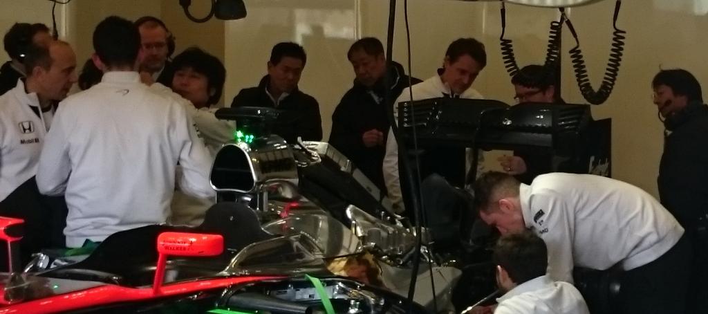

Honda PU

That explains why they need that big air exit for the engine cover.
All in all the driveability of the ICE seems very poor at that stage of testing. Also is sliding in and out of every corner.

Is that a water-air intercooler mounted above the engine?

onewingedangel wrote:Is that a water-air intercooler mounted above the engine?
Yes. Alongside the central air outlet.
