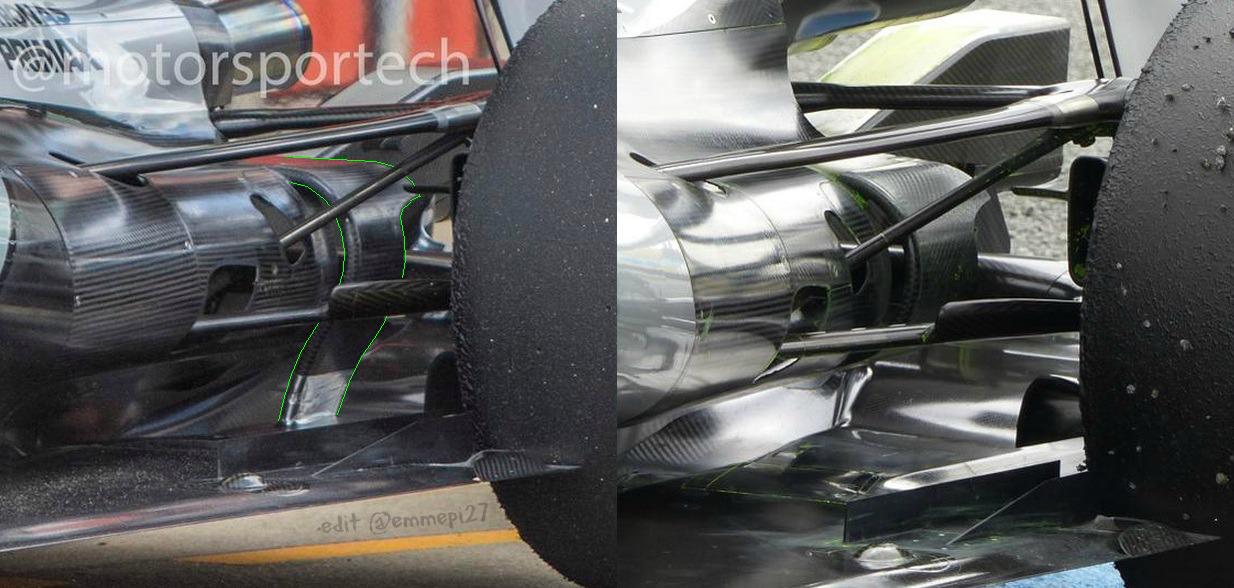

emmepi27
emmepi27
141
Joined: 14 Jul 2013, 12:33
Re: Mercedes AMG F1 W06
Something new there! And also the exhaust seems a little bit different

dren
228
Joined: 03 Mar 2010, 14:14
Nice spot! They have tucked in and slimmed the rear cover a bit and formed a turning vane at the cooling exhaust exit.

arahman_93
arahman_93
Joined: 08 May 2014, 21:27
yeah they have wrapped the bodywork around the exhaust more closely. Image
as well as add vertical vane to the floor where as before it was just like a slot.
arahman_93 wrote:yeah they have wrapped the bodywork around the exhaust more closely. https://pbs.twimg.com/media/B-xgVkLWwAABw5C.jpg:large
Shorter exhaust pipe too.
I`d say it looks shorter and lower...
