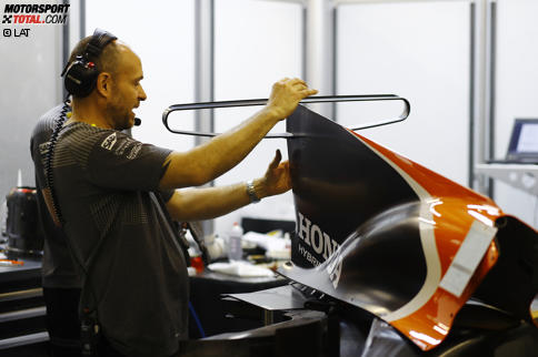

Well if you bolt 10 on then it will have an effect downstream, I would be amazed if the rear wing worked if you had 10 bolted on

RicME85 wrote:
05 Apr 2017, 18:58
That was the point, they do have an effect downstream.

SimonFW11b wrote:
05 Apr 2017, 13:28
Just what McLaren need, more drag
These wings are so efficient, they'll add much more downforce than they will add to drag, so in effect, these things theoretically can reduce drag.

Re: McLaren MCL32 Honda
im quesing top element/wing is to create additional df, lower part to condition the flow to the rearwing

f1rules wrote:
06 Apr 2017, 11:38
Top for DF, lower for structural support.
