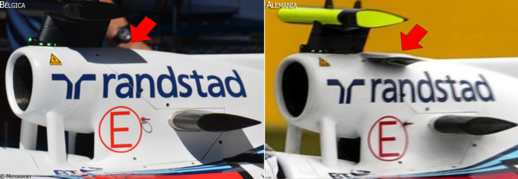

Re: Williams FW38 Mercedes
Tighter coke ?

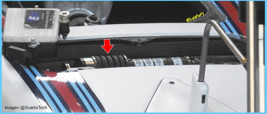

Third element of the front suspension with spring - type belleville

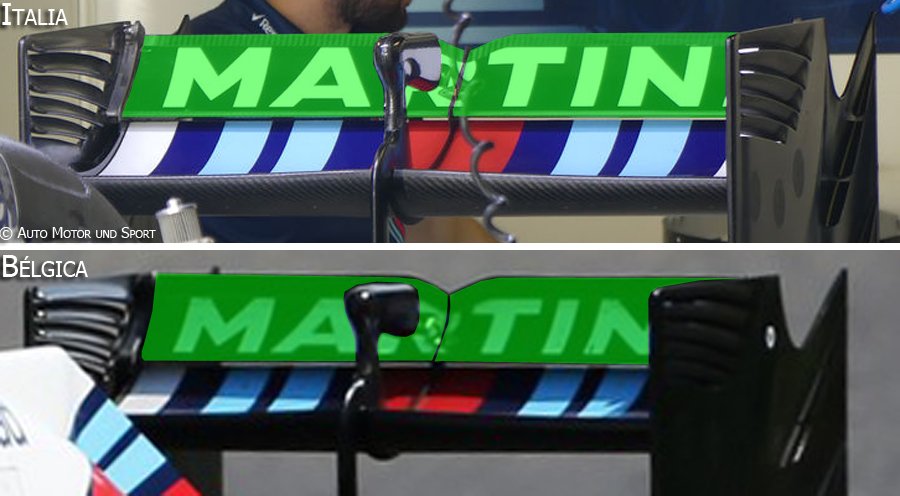

Seems like a lot of wing for Monza, but that seems to be the trend for 2016(i don't know why), bigger wings than usual all around the paddock.
Is power getting to a point where drag stopped mattering as much? That would help explain the recent form...
misterbeam
misterbeam
Joined: 10 Mar 2015, 15:58
Sevach wrote:Seems like a lot of wing for Monza, but that seems to be the trend for 2016(i don't know why), bigger wings than usual all around the paddock.
I would say since 2014 (at least for Mercedes), but it kinda makes sense knowing that these cars have fixed gear ratios, so it's pointless to reduce drag if you 're going to be limited by that.
I believe there isn't much difference between high and low downforce package on most of the cars; some teams keep the gurney flaps on even on Monza.
