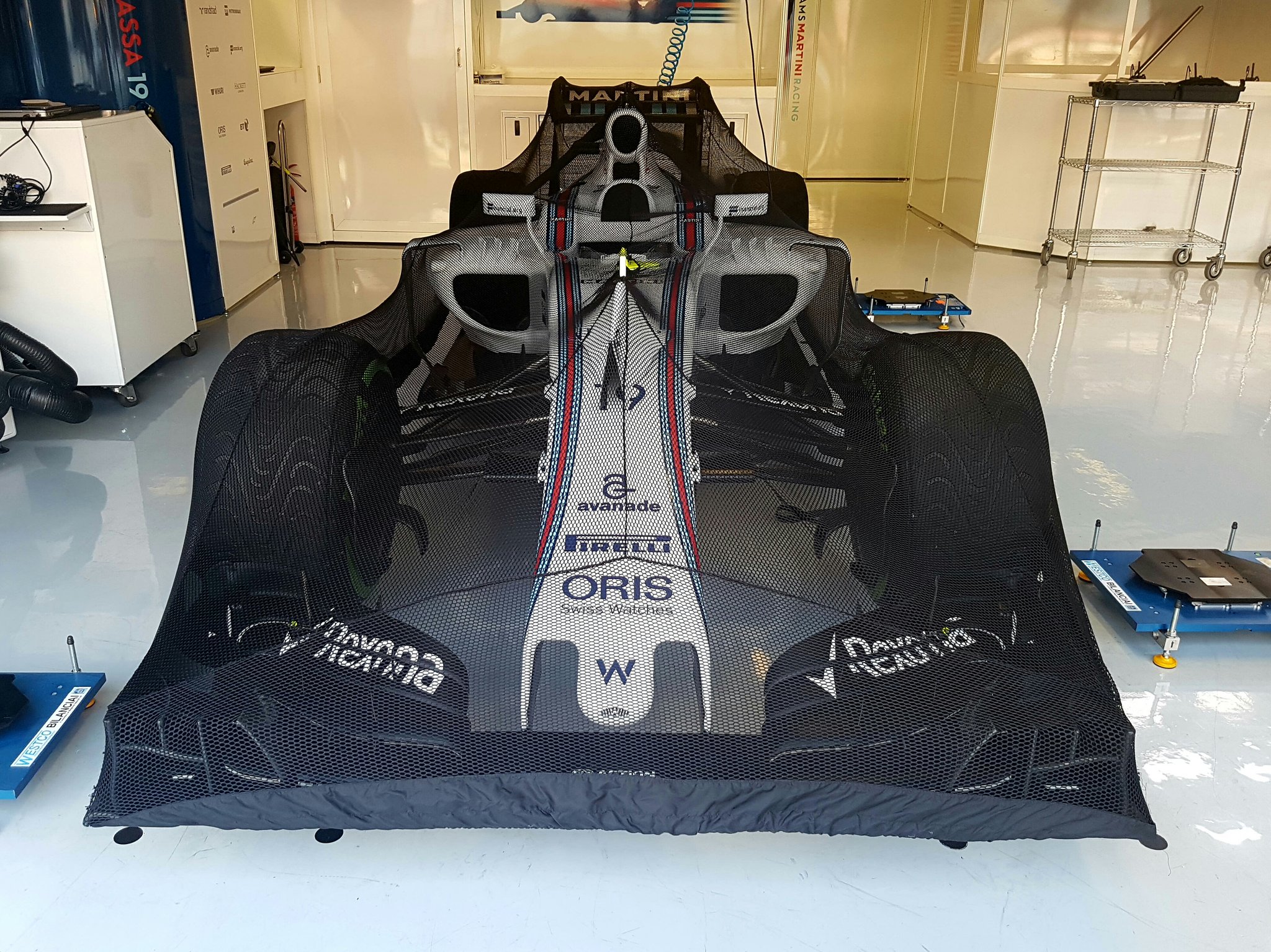

Craig Scarborough ‏@ScarbsTech
Overnight the cars are secured in covers to enforce Parc Fermè.
