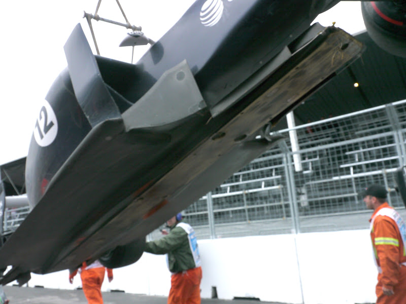

ringo
240
Joined: 29 Mar 2009, 10:57
Re: Exhaust Blown Floor - Forward Exhaust Exit
Shelly indication on this picture, where the side suction is coming from.
