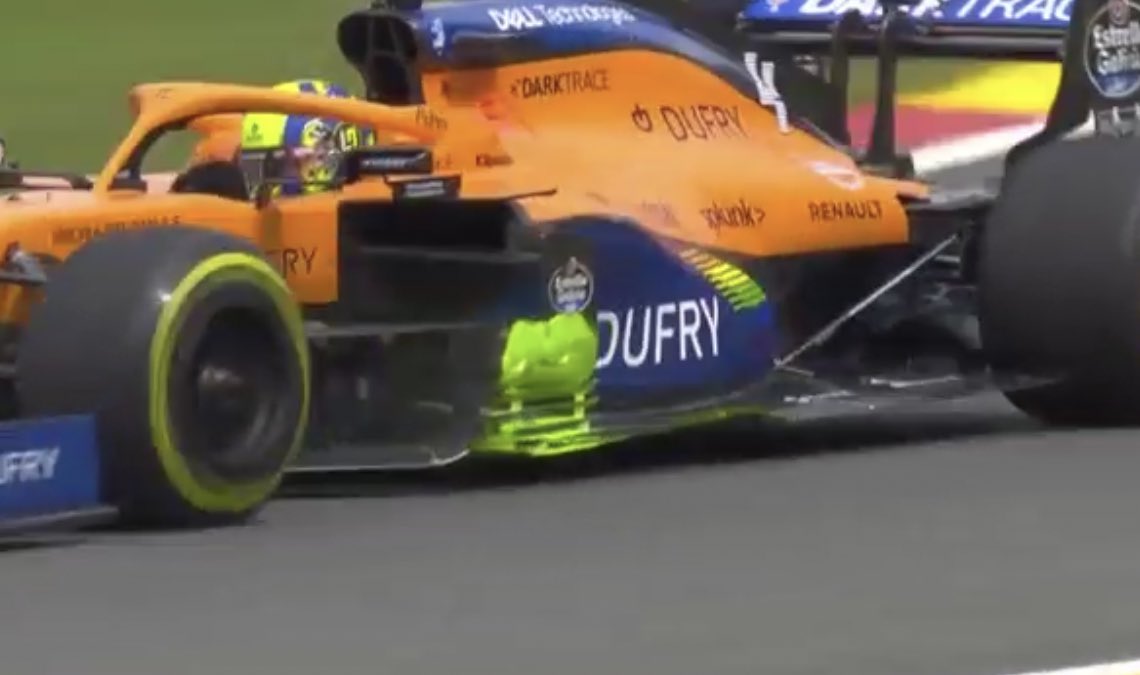

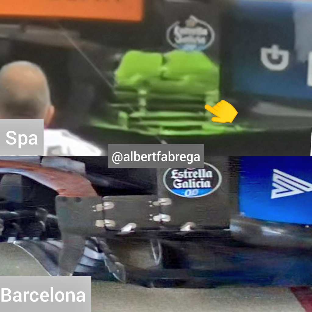

New sidepod deflectors

It seems a few teams moved to this style. Anyone remember the first team to implement, was it HAAS?

Yes. The second I believe was Mercedes in 2019.

It's a good way of creating downforce, as using the outwash from the sidepods means the direction of the drag vector is outwards rather than backwards. So there is not the same drag penalty
