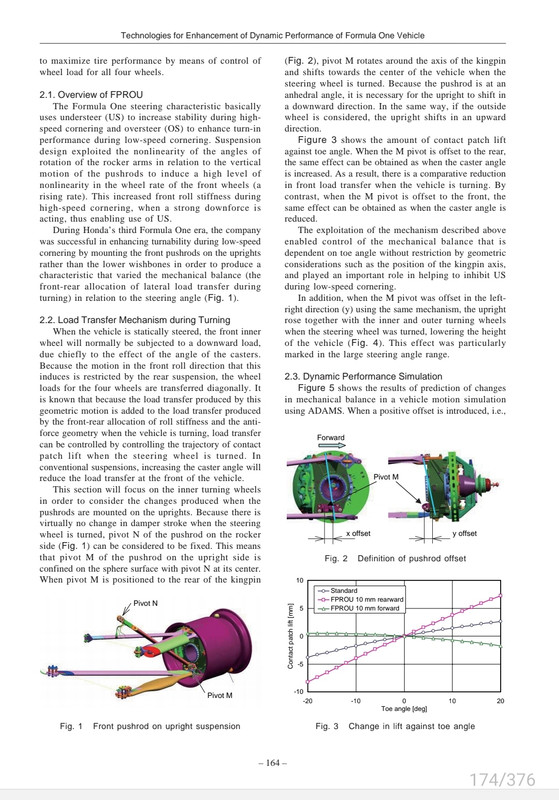

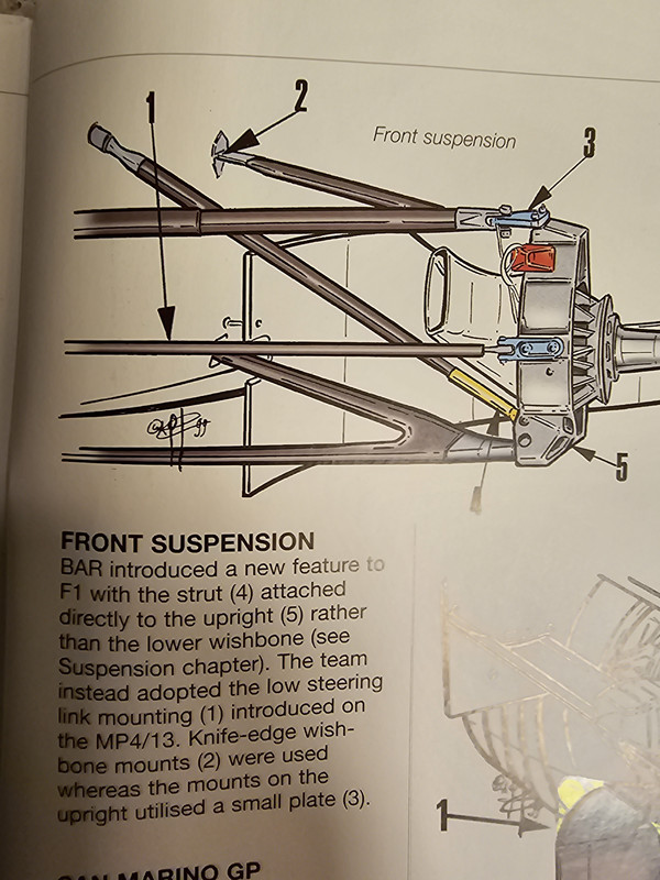

If you haven't found what you're looking for, you haven't looked properly. Here is Piola's picture of the F1-2000 where Rory Byrne introduced the pushrod to upright concept.
Ferrari then used this concept ever since, i think (and never abandoned it) and many other teams copied it, in fact almost all of them in the 2000s. It is also mentioned in Honda's R&D book about their era until 2008. BAR was the first to introduce it in 1999. Here Piolas Drawing of the BAR solution:
Here the site from Hondas RD Book of their third era (untill 2008) on this matter:
Here the complete pages from Piolas book so one can see that its the F1-2000 and the 1999 BAR:
I'll save myself the trouble of looking at pictures of John Barnard's 1994 Ferrari, who used the same concept on this car but, unlike Rory Byrne, didn't get it right (he did not get in the axis, what caused problems) .
So it was more than ridiculous that this concept was hyped so much a few years ago regarding Mercedes, because it had already been successfully introduced in F1 almost 20 years earlier and was then used
by almost the entire field in the 2000s. But this is nothing new and is repeated all the time. For example, Newey's blown diffuser was hyped in 2010 even though it was a 26-year-old concept and the solution was practically a copy of the exhaust solution originally planned for the F300 (which was unfortunately not possible due to the heat protection technology and carbons not being developed far enough at the time and therefore the suspension cooked, which then led to the periscope exhaust) or the hype of 2022 and 2023 around Red Bull's "revolutionary" anti-dive suspension, which has been used for decades...

Sorry, just realised i uploaded the wrong Image regarding Rory Byrnes solution of Monaco 2000 - here is the right one with the right solution on the top, the old version below.
Re: Push rod on upright suspension - an examination
Good find.
The kinematics of it, is to put it on or as close to the king pin axis for the least "bump steer" effect.

PlatinumZealot wrote: ↑
28 Feb 2024, 02:54
Good find.
Is that known as "bump steer" ?
My understanding of that description classically denotes the steering rack ends proscribing a difference in arc to the one in which the upright is notionally completing.
Hence the steered wheels accumulate more toe in or out as the suspension travels from full droop to full bump. The chassis effectively giving directional shift with the wheel held still throughout that compression event.
Mounting the push-rod at a difference to upright axis SHOULD give rise or drop to suspension height through turning the steering, but not alter toe etc.
Castor and akerman would then be in their purest implementation to alter those effects without being "poluted" by an unquantified overlay and amount of pure "bump" steer.

Farnborough wrote: ↑
28 Feb 2024, 11:36
28 Feb 2024, 02:54
Good find.
It will have on effect on the steering becuase it produces a torque around the kin pin axis if it is offset to the axis. The driver will feel it in the steering. In Formula 1 the travel is not great, so that maybe whey they can get away with the amount of steering this push rod on upright can induce if it's off-axis.
