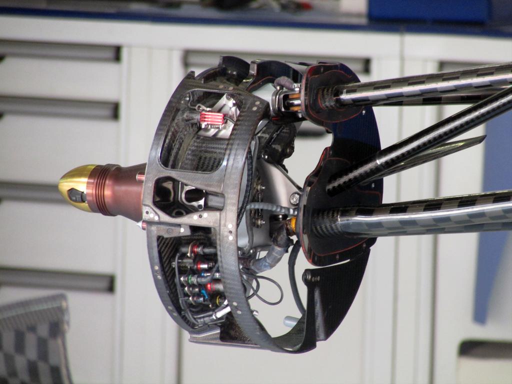

Manor Push rod on upright aligned to the king pin axis it seems:
A Sauber push rod on upright
Then we have the highly evolved Mercedes upright. A naked one is highly sought:

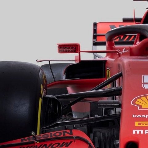

Pyrone89 wrote: ↑
15 Feb 2020, 21:35
Which teams have this on their 2020 car? Does the RB16 and SF1000 have it?
The SF1000 has it. Ferrari had it last year, too.
