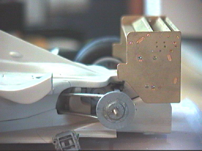

Here is the 1999 wing

Re: Wing Designs of the past
Hope it helps. Right click - view image for bigger size.

the 'boxkite wing' above is also showing a substantial centripetal force and anti-overturning moment ?
operating at a Beta angle of attack around 45deg and significant dynamic pressure
