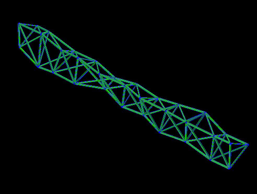

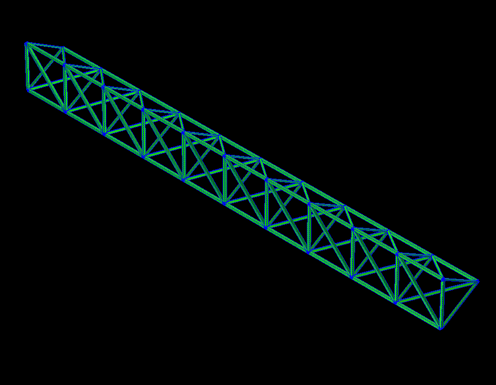

A few years ago I was considering building a space frame chassis for Formula Ford using genetic algorithms I had seen used on space truss designs.
I had seen an article about some work going on at Southampton, they had optimized a space truss design from this:
to this:
And in doing so increased torsional stiffness drastically.
I was really struck that you could take a junior car to another level with some bizarre-looking spaceframe that was actually amazingly stiff. Surely there would be constraints, but optimization programmes allow for constraints (I have experience from another sector).
I would still be interested in funding that project, if anyone is interested in the CAD and FE side of things.

SidSidney wrote:A few years ago I was considering building a space frame chassis for Formula Ford using genetic algorithms I had seen used on space truss designs.
http://www.southampton.ac.uk/~ajk/truss/3dbeam1.gif
to this:
http://www.southampton.ac.uk/~ajk/truss/3dbeam2.gif
That's very interesting. Spaceframes still win at club level because they're dead cheap to manufacture and repair. Many people are moving to carbon tubs, but not many are going faster. If someone wants to do the CAD/FE and you want to fund that, I'll run the car and drive it...

SidSidney wrote:I had seen an article about some work going on at Southampton, they had optimized a space truss design from this:
to this:
Do you have a link to that article? There is something about that doesn't make sense about that final design. One being that for a structure under a pure torsional load, there is no reason to have a varying cross section. Perhaps if it is undergoing other loads along its length then maybe....
to this:
Well they did call it a truss, so I doubt that its pure torsional loading.

Here's the page:
http://www.southampton.ac.uk/~ajk/truss/welcome.html
It was a long time ago, it seems I can't find the bit about stiffness, more frequency response in this article, I but I am fairly sure I was interested for other reasons. I do recall emailing Andy Keane and looking at it seriously for a while, somewhere around here I have a spaceframe model in AutoCAD.
It is interesting how the 2D truss looks like a bone, that's what got me thinking about it.
