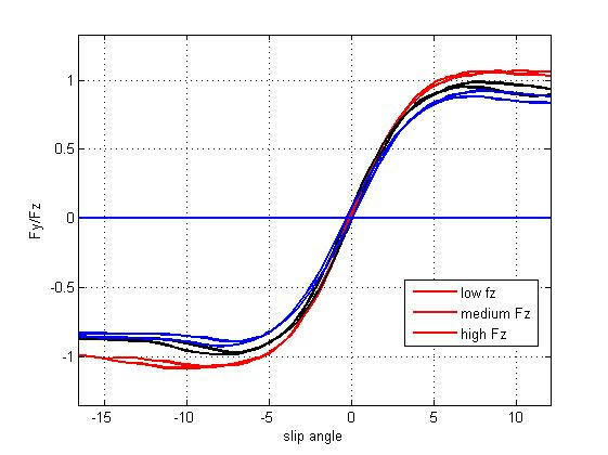

A higher slip angle doesn't necessarily mean more grip.
As you can see here
The red line is a race tire and the blue one is a street tire.
In fact most (if not all) high performance tires produce their maximum cornering force at lower slip angles than street tires.
Of course the maximum cornering forces are higher in high-performance/race tires.
